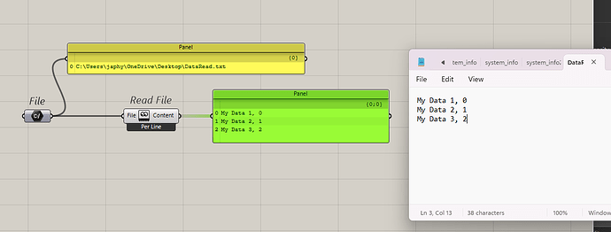

how about a simple .txt or csv file with the native Read File component?

@Larry_Trimboli I gave several options to solve exactly your issue in this topic: External price on shapediver using Excel or Google sheet - #2 by mathieu1
These all involve a centralized way to store your data (either in Google Sheets or an Excel file) which is connected to your ShapeDiver models, meaning you can update the data without having to re-upload your models.
