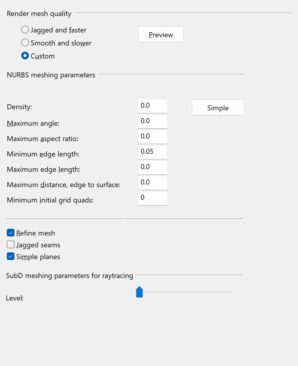

hi @Mahmut_DAMAR to me it looks like it is failing due to the complexity or size of the individual meshes. These mesh settings seem to work, though with a warning:
