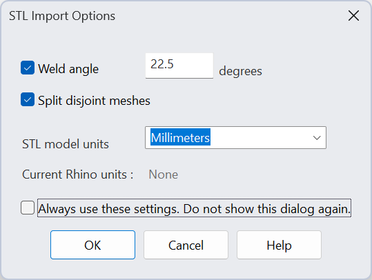

Export Mesh as STL-File
Sounds odd, can you open this one?
test.stl (684 Bytes)
I used this def:
ExportToSTLV8.gh (9.8 KB)
No sorry I cannot open this *.stl
Wait. My and your file opens in Rhino 9 WIP but it crashes Rhino 8
In 8, are you opening thru the File pulldown > Open command?
For me this opens in 8. I am running 8.21 Windows? Windows for your setup?
Trying to determine how open or import might be different?
Yes open command.

How about this STL, used Regular Rhino Export Selected for this one:
Import works with Rhino 8.
Open fails with other *.stl files too.
OK, so in your case import works, but Open does not. That is interesting.
What import options are you using?
The same as on your screenshot.
