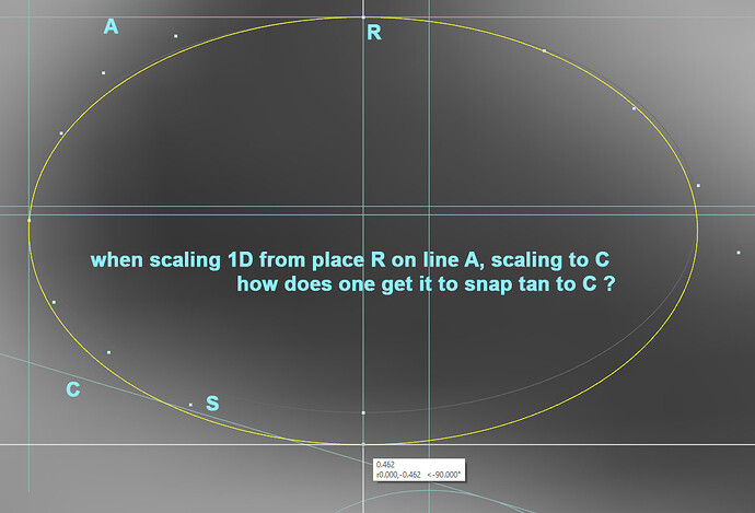

With the discussion on use circle then scale1D it, I cant see how to scale it if two lines are 90deg and the third angled.
got as far as this but how does one scale 1D and get the circle to snap at the tan moment ?

I guess you didn’t understand the solution in the other thread that you linked. It’s not difficult to create ellipse options that fit those three curves, if you also know the direction of the axes. It seems like you want the axes to be horizontal & vertical, so the attached is a simple example. Maybe I need to create a video to explain it better? I just copied your three curves multiple times. Then I scaled each set in Y, then drew a circle tangent to all three curves (I’m sure that tool has been around since v5, right?) Then use the Orient command with Scale=1D option to copy each circle back to your original curves. The scaling factor to complete the Orient command is just the length of B.
