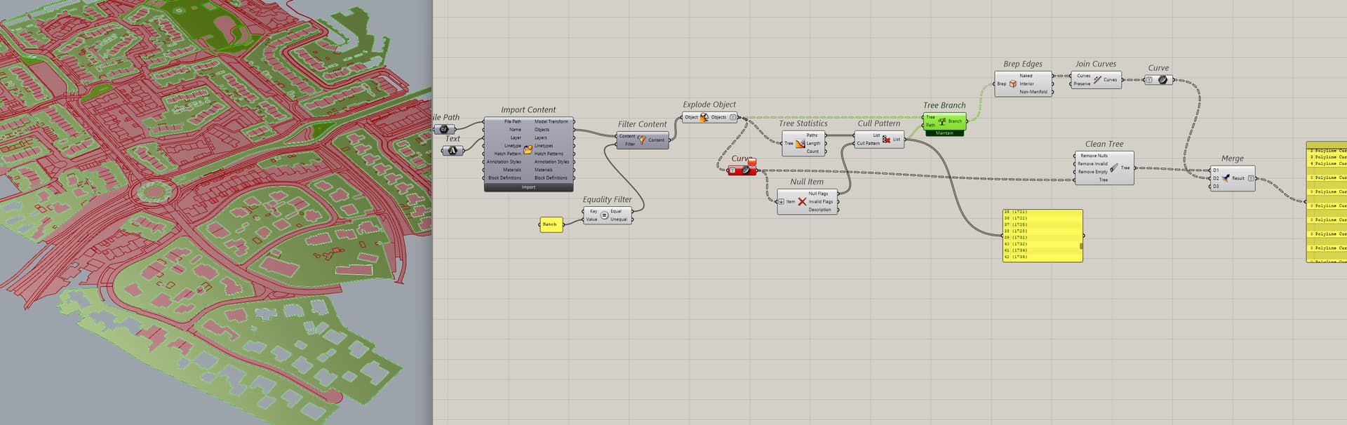

I am currently testing out Grasshopper to see if some actions can be automated in Archicad.
As an input i have a dwg file containing various objects (lines, hatches, text). I tested several nodes and plugins, but did not find a good working solution. As an output I would like an ArchiCAD mesh, using the archicad plugin.
It seems to go wrong at the DeHatch node. It reports Empty Boundary. Does someone have a solution for this or knows an alternative?

Here’s a more Rhino 8 way of doing it.
I’m not sure what the ArchiCAD mesh requires but the surfaces output in the definition attached should help.

Thank you for the reply!
When I use the surfaces as input for the Archicad Mesh Boundary, the node is red and gives the following error: “Data conversion failed from Model surface to Curve”.
The Archicad Mesh node requires the input:
B (Curve)
Boundary Curve of Archicad Mesh.
I tried extracting the edges by using Brep Edges, but this gives the error: “Invalid Curve value. It must be in a horizontal plane and closed”
What other node can I try?
A quick check of casting your Surface to Curves shows the failure.
Isolating all the failures we see that the Islands (interior boundaries) are causing problems

Thank you very much! It seems to work.
Although now it seems it created meshes from all hatches. But I thought I filtered to a specific layer in the Import Content node? I only need the hatches on the layer “wegdeel (vlak)”
