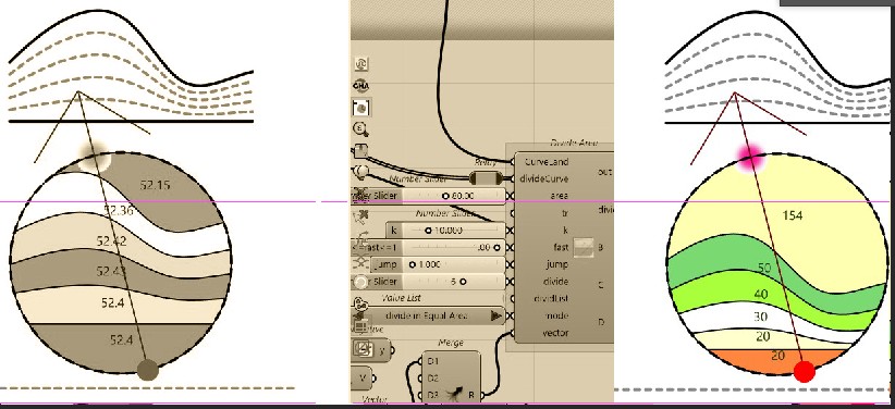

Hi, I wrote c# code to split a close curve (multiple lines) based on area list
My Component has several options:
divide 2 part to Target Area = 0
divide in Equal Area = 1
divide by list of Area = 2
Explanation that this code can divide a closed curve in the direction of the y axis from top to bottom based on target areas
*i share my Code *
If anyone can optimize this code or have a better suggestion to make it faster, please help
to share

it is a kind of brute force
you can use more optimized tool like this one that was used recently by @DanielPiker
the function f(x) is the area depending on the movement in Y.
Here’s my root finding example Laurent refers to:
Not c#, but this solves in under half second.
Fully translating the same algorithm in c# should make it faster…

Similar concept to what already said by others, Curve-Curve boolean intersection + area calc done inside a c# in parallel as Laurent said.
Pseudo-geometric solution, pseudo brute force.
Intersection with the “intergral graph”, which have kinks where the section curve intercepts a discontinuity/corner on the area curve to split.
Yes this one,
with this method and Clipper, searching for 100 areas takes 11 ms.
Not finished code, but the idea is there.

It will work with Nautilus 0.9. But if I have some time I will certainly do an autonomous component.
10 minutes rework
Here a solution with only Rhinocommon and no plugin
The inputs must be closed curves. But it is possible to have a cutter not using a closed curve and close it in the code. It is also possible to the other things inside.
I reuse 2 codes
Daniel Piker tool
And John D. Cook one
divide Area LD v3.gh (15.6 KB)

Great! @laurent_delrieu
But if we use CreateBooleanRegions method
Then we can use to open the curve
Does it have much effect on reducing speed?
I didn’t test this one. The only problem I seebis that you will have to sort the splitted region.
Combining the 2 methods is surely the way to go. I made 3 methods you have another one with Grasshopper component plus the one from you. Up to you to decide from the speed reliability simplicity or whatever.
For my tools I often use clipper for reliability. For example if I made intersection of 2 same curve it work better with clipper than RhinoCommon
