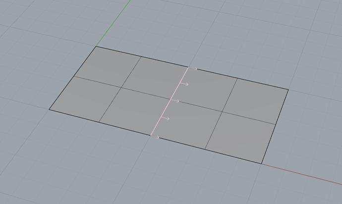

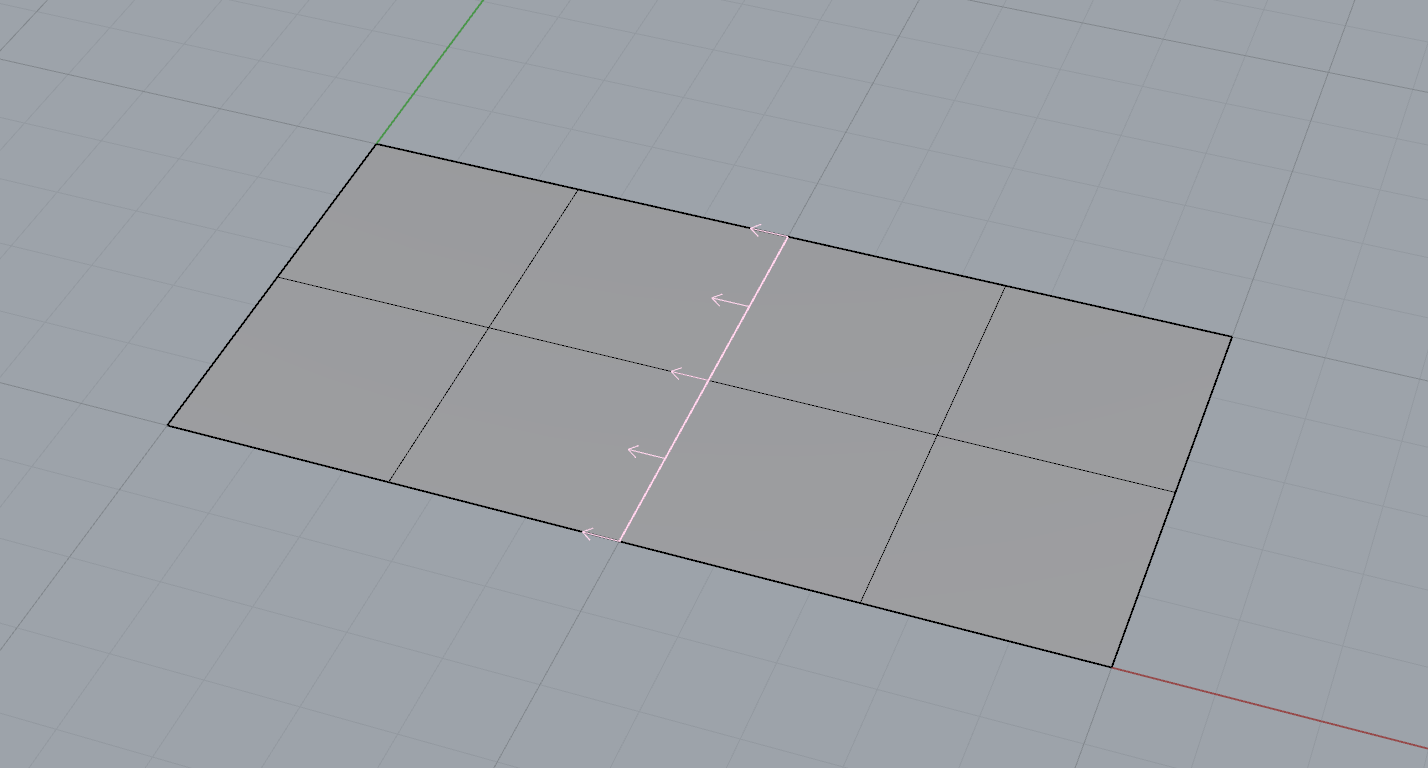

Whenever I select an object of type edge_object, if it’s an edge shared among two brep faces I can choose among 2 options:
If I call
const CRhinoObjRef& objref = go.Object(0);
const ON_BrepEdge* pEdge = objref.Edge();
int indEdge = pEdge->EdgeCurveIndexOf();
indEdge will be the same for the 2 options, so what’s the index/info that tells me the difference? I need the face index I’m referring to through the arrows.
Thx
Nathan

Does this help?
– Dale
I see, so I was confusing edges with trims. This is very useful, thank you!
Nathan
