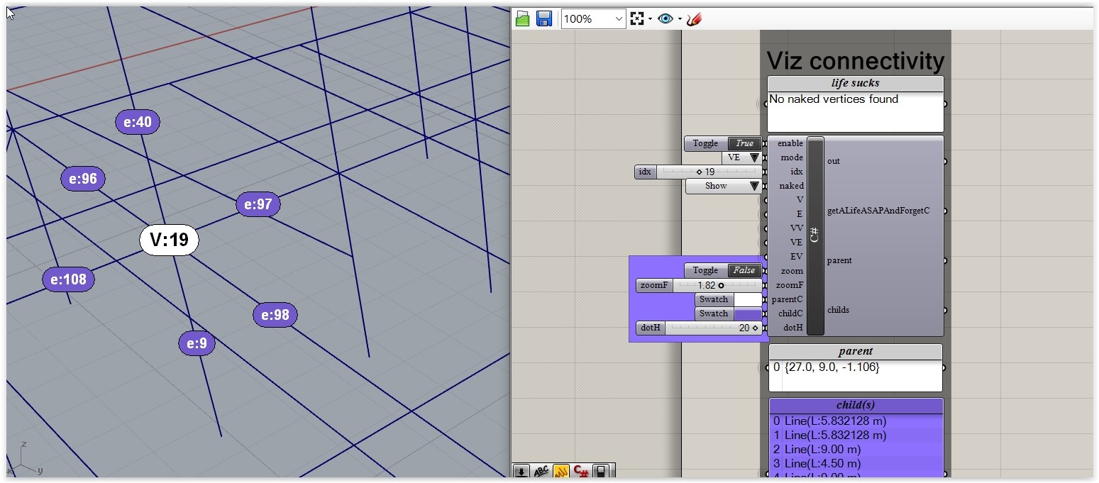

There are several network topology tools in GH, but none of them can solve your topology, simply because you have lines that do not end at the nodes. I made a new one, it can solve this case.
This issue of yours is a typical case … where the pro solution is done via code.
  1. Imagine that you have a Graph. Then you should find the classic VV, VE and EV Connectivity Trees (V for Vertices [Nodes], E for Edges [ Connections]). You should also find possible islands (Isolated parts of the Graph) using solely VV Conn (and Recursion).
  1. Then you create objects (That’s what a Class in C# does) that contain info about all the above … plus the Name of the connection section (HEB, HEA, IPN etc).
  2. Then you can perform any query (flat or nested) imaginable. Like “list” all the information available (in any imaginable way) or find all HEB’s with a Length within a given search Interval or find all Nodes with some given valence V that are connected at least with s Sections of Type t … blah, blah.
Shown 3 demo outputs (with focus on Nodes or Connections/Sections) where section Names are randomly assigned (obviously not the case in real-life … but I do hope that you get the gist of the whole thing).
If you want an entry level C# that does the above (say: BIM “like”) notify.
That said R/GH are NOT the apps for BIM adventures (nor they would ever be)
I’d be interested in one. I am planning on creating my own solution to something very similar using C#, but it would be nice to get an alternative solution. That way I could learn more about it.
Get an indicative 4 C# combo.
The 1st gets Lines (as Graph) and does the Conn part (but NOT the possible Graph islands - that’s strictly internal stuff), the 2nd is solely for Vis Conn purposes, the 3d does the Node/Edge Classes (and assigns rnd section names/sizes to the Graph Edges) and the 4th reads the 2 Class derived Lists (as Type objects) unboxes their content (notice the same [to3rd] Classes definitions) and finally does 2 entry level - indicative - LINQ queries.
Note that each time the 3rd re-executes (rollTheBones slider) assigns randomly different sections (it’s just a very simple demo after all). So is paramount a separation between the 3rd and 4th C#.
As a challenge do various LINQ queries (and maybe a 5th C# for visualizing the results).

Should the VE relations at the node also include line 64?
Not only 64 but the Line above as well. UNLESS line 64 has no end at that sphere of yours (the C# assumes that each line has at least a common pt with another - so it doesn’t prepare data by any means - i.e. “splitting” lines VS lines so to speak, checking for dupes etc etc).
See for instance (yellows are Polylines [so: not invited to the party] and then exploded to Lines);
Anyway post (in R5 format) that line combo of yours shown.
