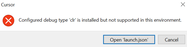

Does anyone have experience with debugging Rhino plugins with Cursor?
I’m contemplating switching from VS 2022 but can’t figure out how to run a live debug session targeting .NET48. netcore works fine, but netfx gives me the following error:
Both Rhino 7 and Rhino 8 with the /netfx flag fail miserably.
Any ideas?
The plugin multitargets two frameworks:

And then in launch.json I first pre-launch Rhino, and then attach to the running process:
  "version": "0.2.0",
  "configurations": [
      "name": "Rhino 8 - netcore",
      "type": "coreclr",
      "request": "attach",
      "processId": "${command:pickProcess}",
      "preLaunchTask": "launch-rhino-for-debugging"
      "name": "Rhino 7",
      "type": "clr",
      "preLaunchTask": "launch-rhino-netfx-for-debugging"
  "compounds": []

This may be a slightly different question.
It seems that the C# DevKit only works with VSCode now.
What debugger are you using?

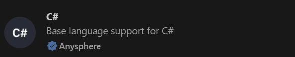

I’m using this extension:
