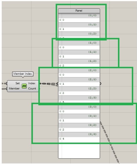

I want to have these data together not separated. How can I do that?
Try the Shift Paths component
Hi Setareh,
pick the indices that you want to put together and flatten.
Cheers
Flatten puts everything in one branch. If you want four branches, shift paths is one of the options.
