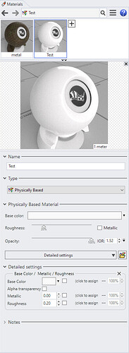

@andy Here’s my opinion on the material editor: As an example I’m taking the PBR, since that’s going to be the go-to material I think for the future. Of course we would better have a node based material system, but that’s another story.
Anyhow if I look at this:
The text in lower half Base Color and the little color icon, then the checkbox, then (click to assign then … then 100% spinner
I hardly know where to start, but imo it is a very unpleasant graphical composition. Text Base Color and (click to assign don’t line up (red line), the spinners are not the same height (purple lines), the white space is inconsistent (green lines), the check boxes don’t line up, everything is squarish but then the group border has rounded corners, the cross to close it has a background color that is just off from the rest of the background.
While using it I found a bug that if you change the base color, and delete the detailed settings, the base color gets reset to white.
