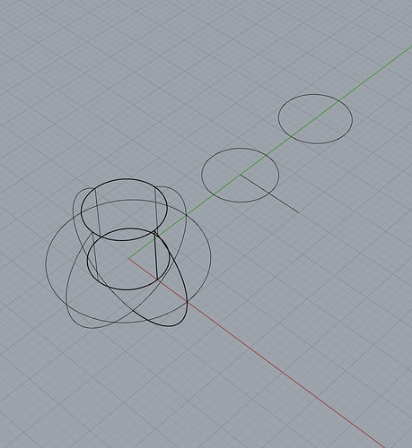

We are working on upgrading one of our Rhino plugins from Rhino 7 to Rhino 8. We came across the following bug with ProjectToPlane for specific breps and curves.
The code below creates a sphere with a cylinder that removes the center of it. When you project the faces of the Brep to the world xy plane it works fine and generates the curves as shown below. In Rhino 7 it works fine, but in Rhino 8 it fails.

Hi @SK-Structurecraft,
In Rhino 7, Curve.ProjectToPlane used to convert input curves to NURBS before projecting. Otherwise, projecting can fail on some non-deformable curve types (lines, circles, etc.).
This is no longer the case in Rhino 8.
To fix your code, do this:
Curve loop = face.OuterLoop.To3dCurve().ToNurbsCurve(); // nurbify
– Dale
Thanks for the quick reply. Tried it out and that works great. I think that should fix it for our case.
Are there any other Curve methods that need similar fixes?
