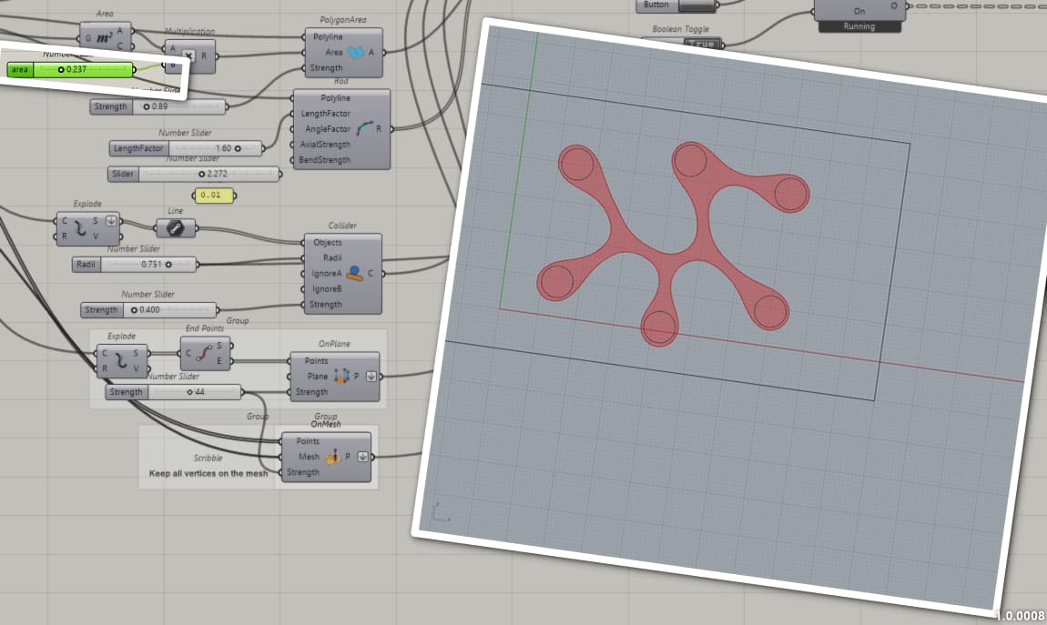

You could indeed also use Kangaroo to relax a membrane between some fixed points or boundaries:
tensile_blend_Kangaroo.gh (95.8 KB)
Here a little test with Kangaroo, I reused Squishy curve example.
You’ll have to initialize with area slider near 1 and then decrease it.
Here I added another component to draw the convex hull (it could be a plugin but coud be draw by hand) using points and not circle (use Nautilus)
curve around poles.gh (26.8 KB)
I also notice that in the top-down view of this building, parts of that inner curves nearly (or did indeed) touch itself
Yes, it surely requires more work on Kangaroo goals in order to reach such a shape, some attraction like in Squishy curves.
