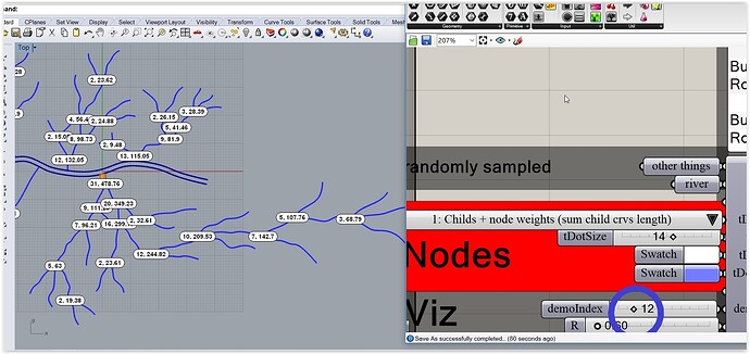

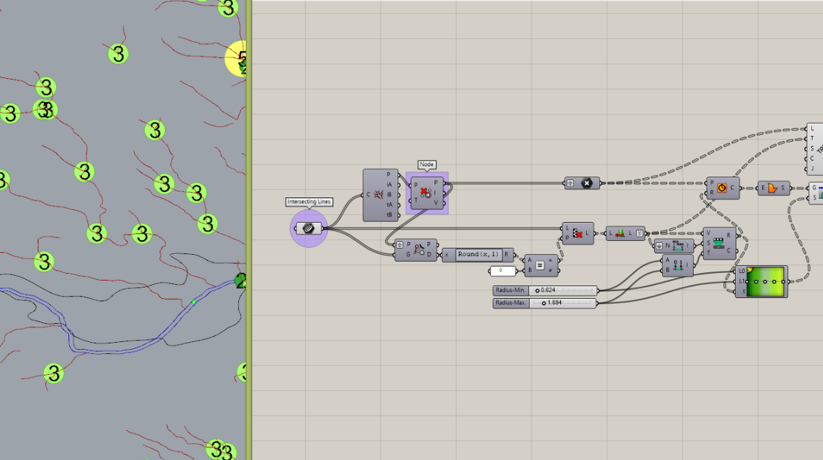

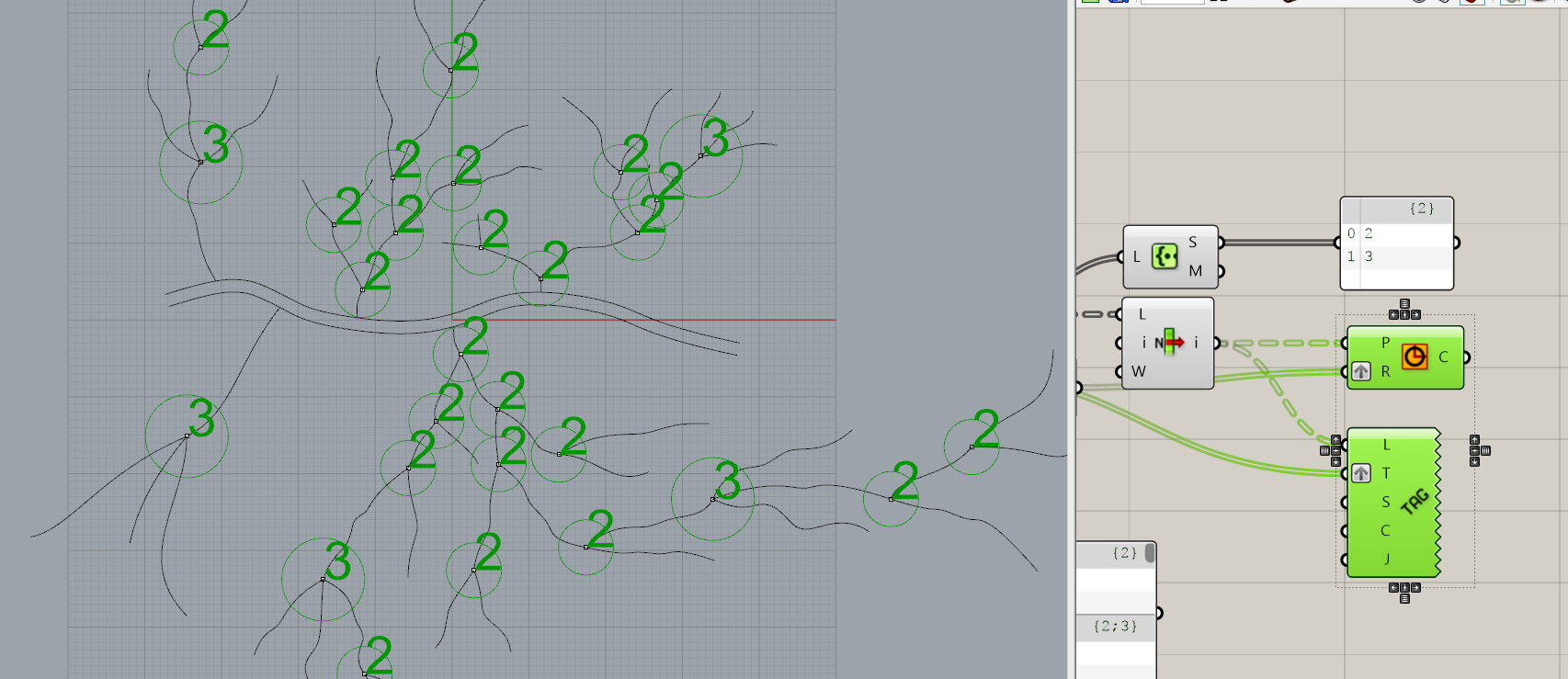

Hi everyone, I was hoping if someone could give me some ideas on how to achieve the following:
I am currently trying to find the places of most accumulation of water, to make it simple I am assuming these are the places where more streams intersect.
With an old definition @HS_Kim provided I was able to find the amount of intersections.
But I am wondering how to make a cumulative count to the river curves. (like shown in the first image).
I hope this isnt too complicated. Any insight much appreciated.
Intersections.gh (20.6 KB)

You can make a program (C# …) to count from trunk to leaves … Is it more orthodox ? :wedding:
Counting is recursive so graph traversing is necessary.

the general sequence that I have used on a project that is conceptually similar, modeling tree branches, is:
  • find points of all tree intersections
  • do a shortest walk, for each point, to a convenient origin
  • for each curve from the shortest walk, explode the curve into segments
  • the count of number of elements for each group of segments will be the cumulative count
as Laurent already mentioned, Daniel Abalde’s shortest walk script is a great example to follow

In this tDot display mode you get the crv lengths (blue) plus the sum (white) of all child curve lengths (per node):

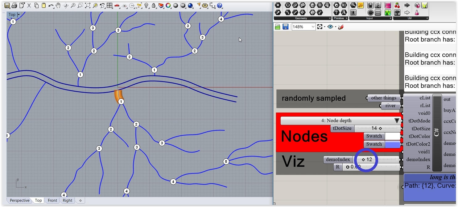

in this tDot mode you get the node depth:
BTW: Use the index slider in the Viz group to get the curve in question plus the path to arrive there.
Added just 2 lines more : now you have the child count (per node) as well + the node weight (sum of all child lengths).

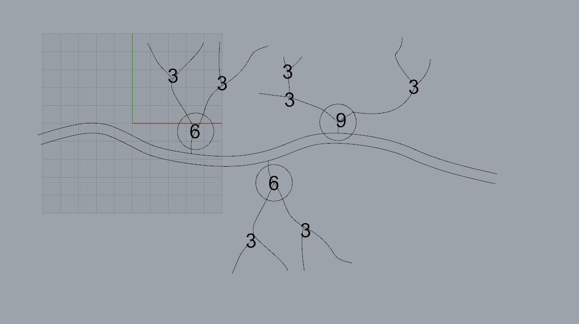

Thank you Peter, I have now checked your script. And I am afraid it needs a little twist:
To clarify the direction is towards the river, this means from many nodes towards one node. I think in the script you provided is the other way around.
And also, what I really need is the accumulation count of nodes as you travel down the tree. (You start to count from the branches towards the trunk as stated above).
So once you get to the trunk a number should represent the quantity of branches in that tree. Being able to tell the biggest trees from the smaller ones.

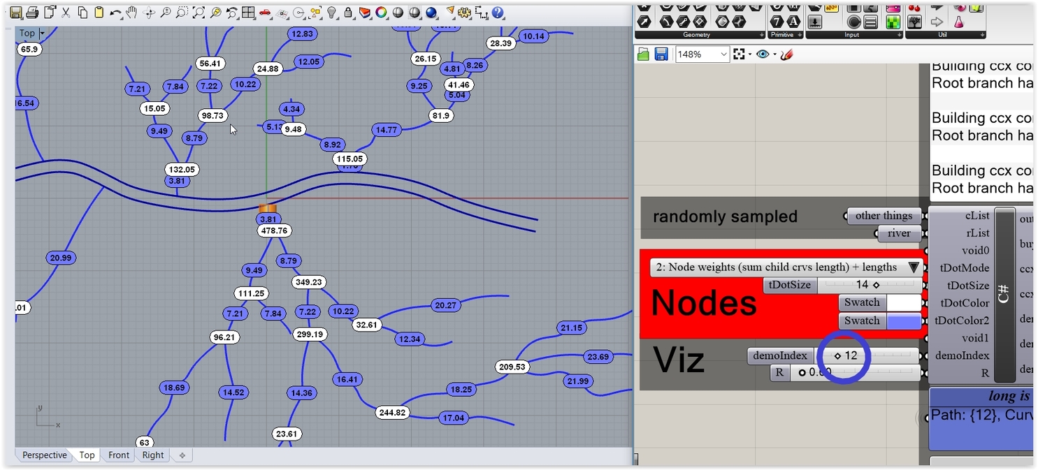

That’s one line more but I’m not at home right now … for a given node you just have to resrtict counting only to first generation (of node’s child paths in the dendrogram >> GH_Path.IsAncestor Method ).
BTW: As you travel towards the root sub-branch (towards the river [ i.e. a branch with a single dimension represending the index of the curve]) the first text Dot number is the sum of all child paths … so if you want to calculate some imaginary flow (using the second text Dot number)… blah, blah.

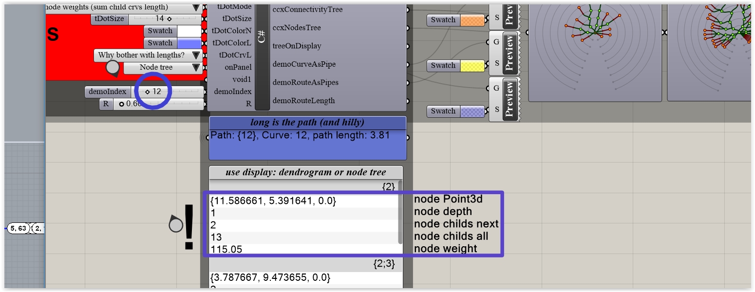

In any case the general solution is an object type node DataTree (with lot’s of info other than the node Point3d … like the gen 1 childs, all childs, lengths, depth, cats and dogs) .
Then you can choose anything you want to play with.
Here’s a preview of the new nodeTree (minus the stupid bug that escaped the quality control (%#$ happens) : sorry about the double node points). Not sure if I can find the time for changing some things (tDot display etc) as well (required for the new structure).
The 10 critical minutes found. Get the (bug free) thing and do whatever you want.
Recursion_on_Intersections_V1A.gh (145.6 KB)

Thank you Peter, exactly what I needed.
