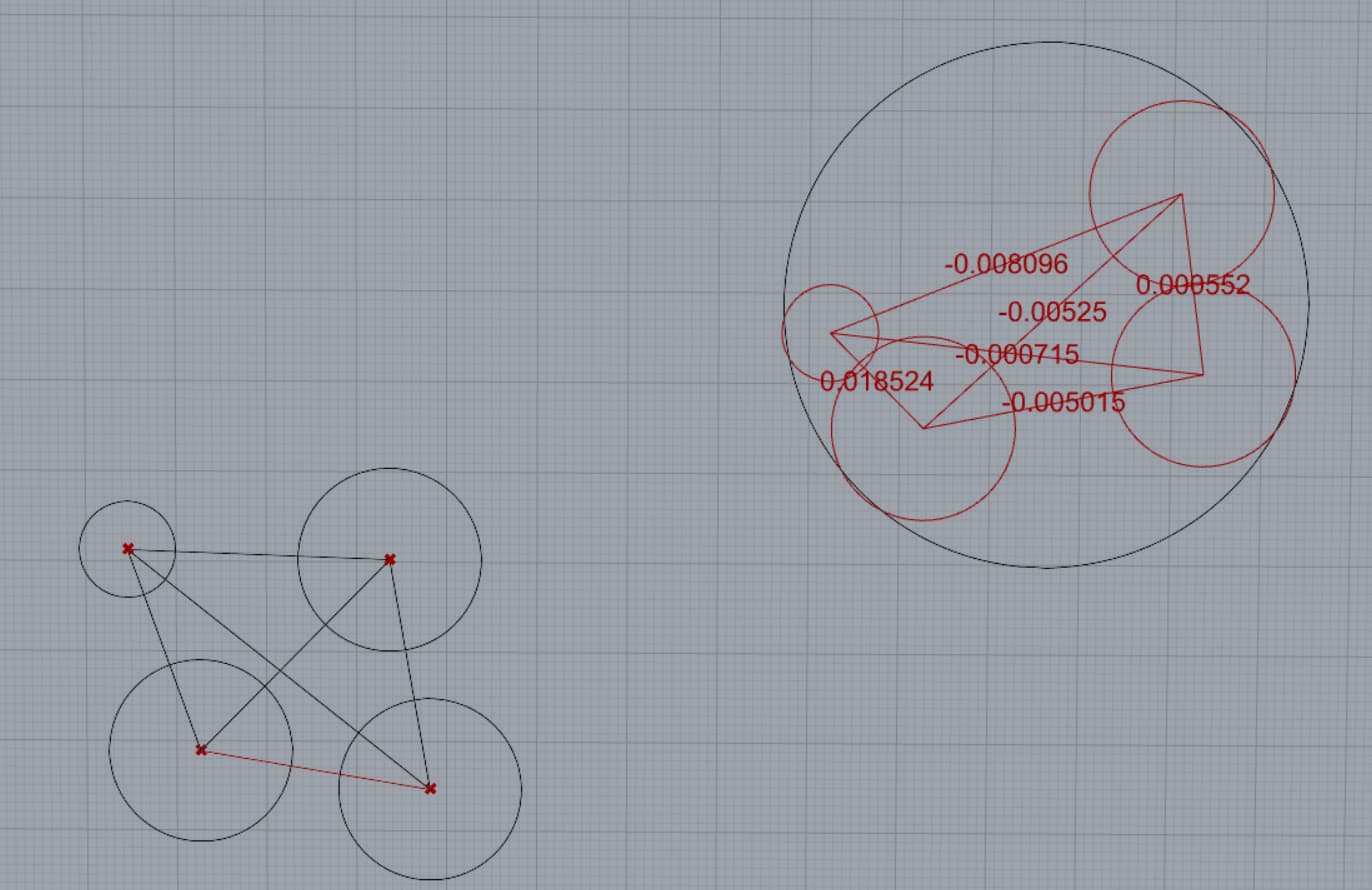

I am currently developing an algorithm for analyzing architectural drawings as part of my architecture graduation project.
My primary objective is to represent the relationships between spaces as a bubble diagram, based on the normalized drawings.
I have already solved the issue of expressing the relationships between rooms through traffic connections, thanks to the help I received through a previous question.
I have also adapted the algorithm for creating the bubble diagram.
However, the results were not as expected, as the bubble diagram did not cluster properly.
I believe the issue lies in the bubble diagram algorithm itself. The absence of repulsion forces prevents proper clustering.
To address this, I modified the algorithm so that repulsive forces act when the distance between objects exceeds a certain value (e.g., the average distance), and attractive forces act when the distance is below this value. This seemed to work well.
However, when I applied this algorithm to the drawing analysis file, it did not function correctly. The problem seems to be that the sum of the repulsive forces is too large.
I am attaching the algorithm I created. I would greatly appreciate any ideas or algorithms that could help resolve this issue.
