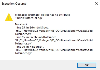

Dear Helvetosaur, thank you. I tested the py-script with the example (SolidTest02.3dm), but it didn’t work. I get the attached warning. What did I wrong?Warning
Odd, it works here on your file. Hmm, are you working in V6? If you are on V5, it looks like you could get that message as the ShrinkSurfaceToEdge method did not exist in V5…
After installing the updates, it worked. Thanks.
OK, that method might have been added sometime during the course of V6, I don’t know when. Let me know if the script is actually useful to you…
