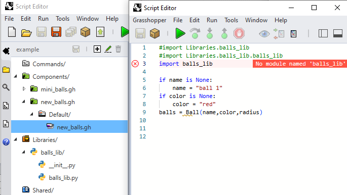

Another related issue is that the “Ball” class should be a library, imported from the script within the definition of “new_balls.gh”. Somethin like this:
However, if I do it that way, I can’t manage to import it directly by writing import balls_lib in the script inside “new_balls”.
Is it possible to import own libraries into grashhopper scripts in this way?
@carlos The script component has a hidden library property that you can use and point to the path of where the python library is stored:
This library property will NOT be included when you publish your scripts as component since the project already has the library.
Hope this makes sense. Let me know if it does not and we can improve the experience
