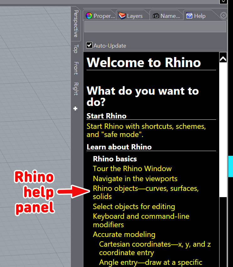

You can display Rhino documentation in Rhino Help panel, as shown in the following screenshot.
CommandHelp command opens the Help panel. You can also open this panel (and other panels) by clicing gear icon shown in upper right corner.
