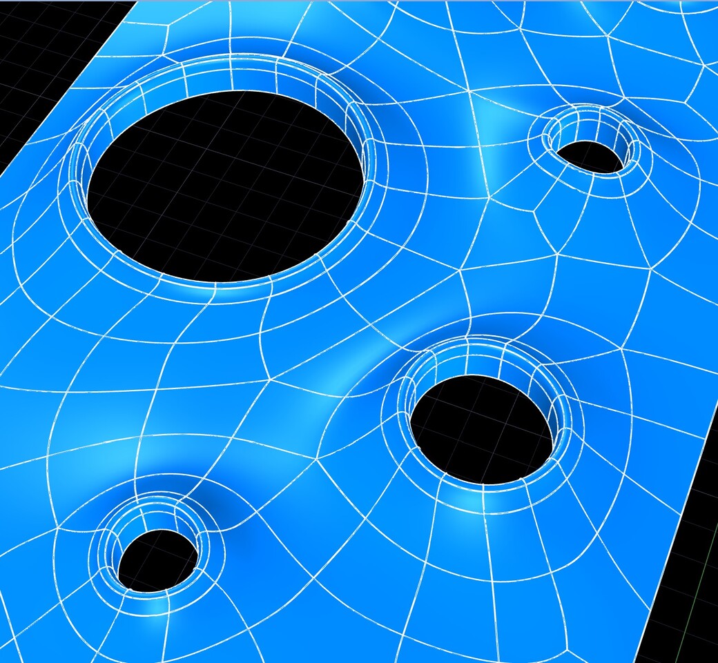

I have a subD that I want to add to using grasshopper. To do this, I first converted to Mesh.
This is a simple example goal: (one simple ring of quads added to each hole in the mesh)
When I use Mesh Loft from Mesh+, I get creases at the seams.
When I extrude the edges of the holes of the mesh as nurbs surfaces and then convert to mesh quads, I get only one ugly creased edge:
When I use Wombat’s Extrude as Mesh, I get the desired result, BUT according to the panel, the output is “invalid mesh”, and also this limits me to only extrusion, I can’t create lofts and attach them to my starting object:
Here is my definition: It requires Mesh+ and Wombat. It has a couple stream filters in it to test methods and test what happens when the mesh through weld and unweld after joining it. I have also tried the crease settings on the SubD from Mesh component in various combinations, and none seem to get me a reliable result. With Wombat and Mesh+, changing the crease settings on the doesn’t do anything, and with a converted brep changeing the crease settings takes it from bad to worse.

I haven’t checked your definition as I don’t have those dependencies. In my experience, these kinds of issues happen you have identical vertices on top of each other. Though there’s often other issues that can creep into your mesh.
Pufferfish’s rebuild mesh can often fix these kinds of problems, especially the weld vertices and identical combine option.

One of the obstacles with things like welding vertices in a global operation when working with subDs is that a lot of mesh components triangulate ngon mesh faces whether you want them to or not. We’ll see if pufferfish plays well with Ngons.
Rebuild Mesh was somewhat helpful, thanks.
