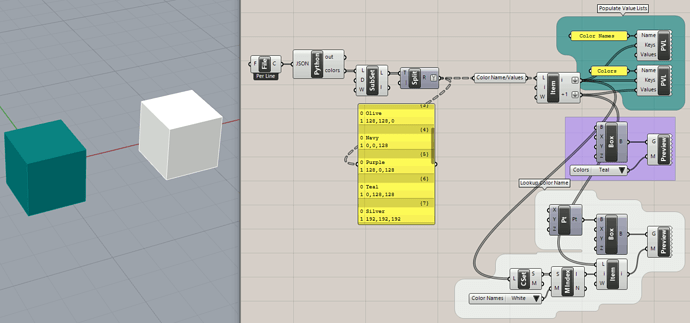

No I dont want to split the colors. I´d like to have a visualisation directly on the GH canvas. Like this:

This may be overkill but I found a list of “web safe” colors here:
Then parsed the JSON format in Python. As noted on the page, there are duplicate color names in this list so I used only the first 16 colors and ignored the rest. There must be CSV or JSON formats with unique color names but I was too impatient to search further.
colors_2021Jan16a.gh (20.2 KB)
colors.json.txt (30.0 KB)
The Python could be ignored by internalizing the Color Name/Values data param.
The teal group uses a PVL component posted recently by @AndersDeleuran to initialize two Value List components:
  • ‘Colors’ in purple group has both names and color values.
  • ‘Color Names’ in white group has only names and does a lookup of the color value associated with the color name passed to the ‘M’ input of MIndex (Member Index).
Here is the Python code:

Created a CNLU (Color Name Lookup) cluster that returns RGB color value for color name.
colors_2021Jan16b
colors_2021Jan16b2
colors_2021Jan16b.gh (9.5 KB)
