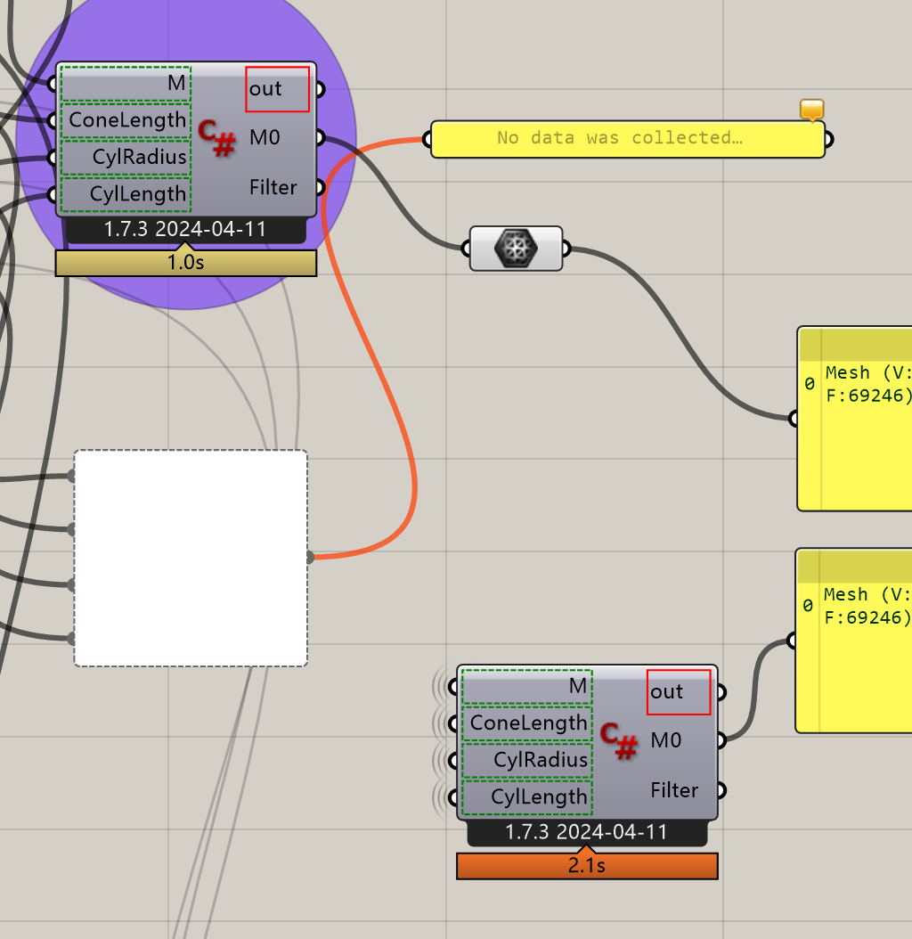

Yes. On the Release build. Still ~20ms.

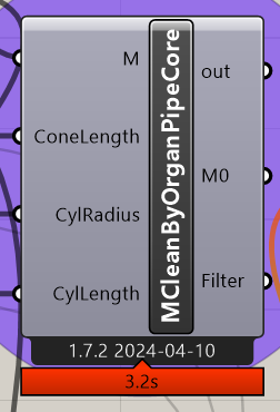

But, then I also tried to modify the code a little, in VS2022. For example, I originally had two loops with Parallel.For, like so:
Parallel.For( /* Traversing Mesh Vertices */ )
    Parallel.For( )   // <-- skipped this one
         // PointInCylinder test.

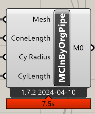

Removing the inner Parallel.For reduced execution time almost 10 seconds…
Then in the PointInclusion method, I also tried make local variables of the signature parameter properties, and for 3 of them it reduced execution time with 1-2 seconds each(!). That was surprising.
So now I’m less than 10 sec on my old 6/12 i7-3930K (lowest was around 7.5 sec).

This small modification meant almost 3 sec shorter execution time, which I really didn’t expect.
Of course I also pasted in the code above into the ScriptComponent, and that gave me yet another positive surprise (3.2 sec!):
Would be nice to get similar speed in the VS2022 version as well.

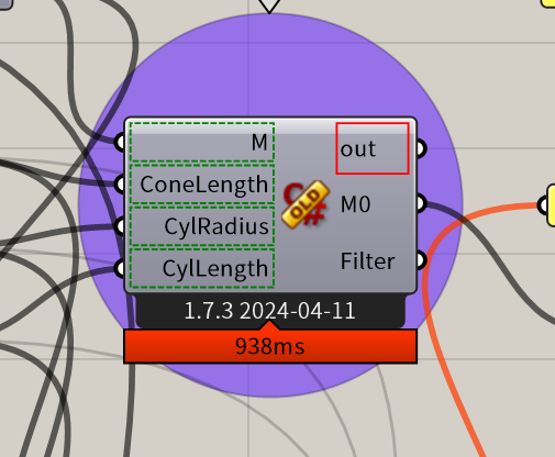

Edit: Latest optimized ScriptComponent version (1.7.3):
MeshCleanByOrganPipe 2024 R7-1.7.3.gh (1.8 MB)
MeshCleanByOrganPipe 2024 R7-1.7.3-Gan.gh (1.8 MB)

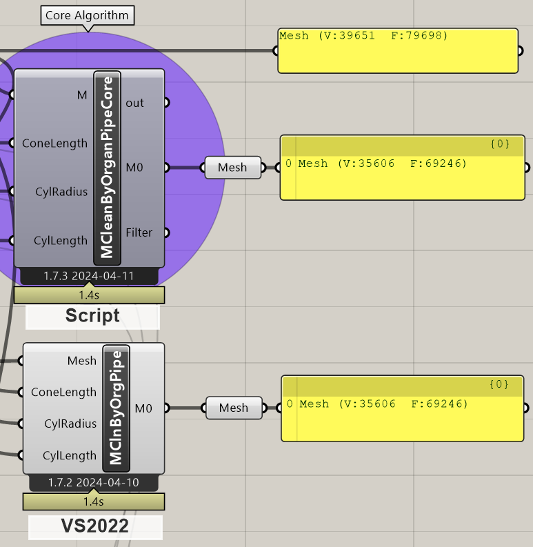

Newer versions of .NET put it under 1s with Rhino 8.
Something might be wrong with your VS configuration.
We’ll see, I will try in VS2022 tonight. Looks good on your side!
Very nice code you wrote. :+1:
//Rolf
I didn’t write much. You write very nice code. :wink:

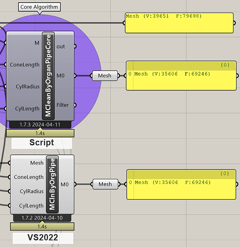

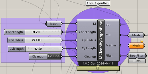

Ok, now we’re talking! I updated the VS2022 code with your modifications, and off we go. I arrived at 1.4 sec also with VS2022.
Absolutely stunning speed! Thank you very much @gankeyu , I knew you would squeeze this thing, pushing it to its limits.
:+1: :sunglasses:
//Rolf

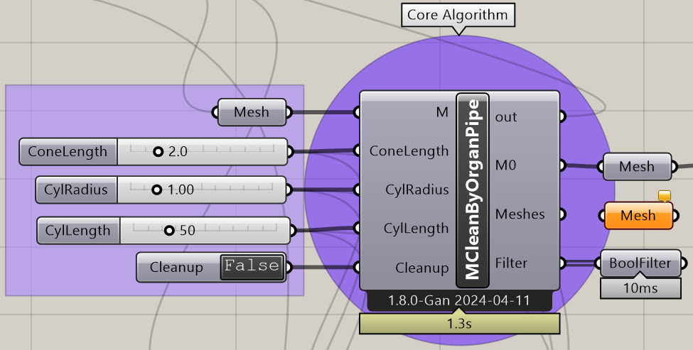

A final version, based on @gankeyu 's very efficient code. With some added functionality when the final removal of the Vertices “inside” is done either inside the component (see option Cleanup == true) or if connecting a Wire to the Filter output, the cleanup can be done outside the Component (the code check’s if a wire is connected). Same thing with the “Meshes” output: Sometimes you want to deal with the DisJointed mesh parts separately.
So here we go: Version 1.8.0 dedicated to @gankeyu (“1.8.0-Gan”):
MeshCleanByOrganPipe 2024 R7-1.8.0-Gan.gh (1.8 MB)
