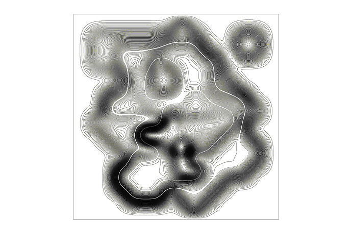

I am writing a script to classify nested curves. The goal is to identify the outer bounding curves (the red contours in the attached picture) and the inside curves (the blue ones).
My current script works, but it becomes very slow (or ‘laggy’) when processing a large number of objects. How can I optimize this script for better performance?
