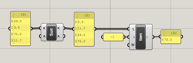

I am trying to only get the largest number from the two entrys. how do i do that. this only works if X is larger. GH%20test%20big
Hi @Glugwort,
Simply sort the list and get the last item from the sorted list:
53

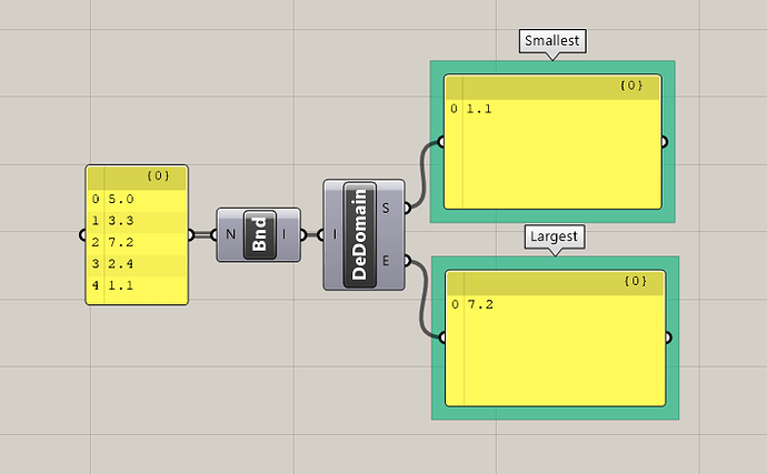

Just another short way as well. Bounds > Deconstruct Domain.
