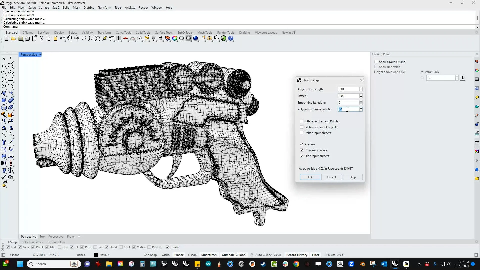

Hi @ryan272727,
You might grab a Rhino 8 Evaluation and have a look at ShrinkWrap.
