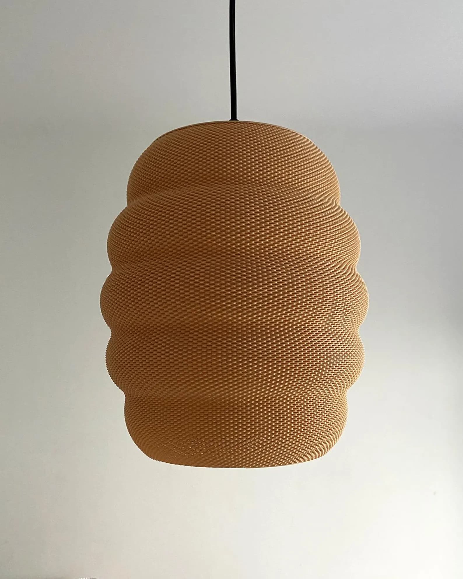

Can somebody help how to make this lampshade forms?
Hi! Can somebody help how to make this lampshade forms (not texture)?
as a start?
lampshade.gh (17.7 KB)
but color and pattern make them interesting…
Please how to make this form?
make different sized stacked tori (donuts), boolean-union them, and fillet their shared edges.
https://discourse.mcneel.com/t/rippled-mesh-texture-for-3d-printing-grasshopper/203645/8
This link is very similar. Try and understand this script and modify it to the geometry that @Jakob_v_Schirmeister has kindly created.
