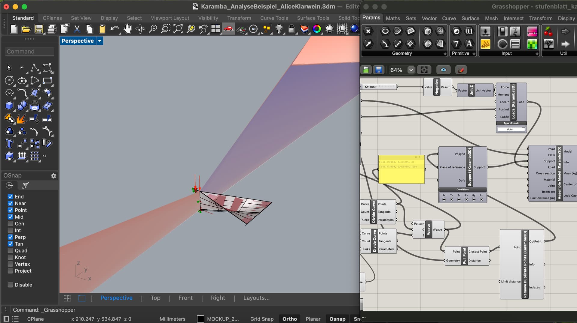

hopefully my last question … what is happening to the force visualisation?
I am not entirely sure what is going on.
(if it helps I can also upload my files?)
thank you already for the support
It may be due to the deformation scale in the ModelView component - set the slider to a lower number.
