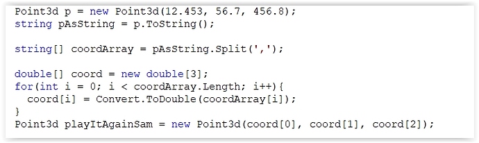

I have a new problem ( i think it’s easy…). I have convert my Point3d to string, now, i want make string to Point3d.
I don’t know how convert this… Can help me ?
Why you did that?
Yes, thank you !
I had tried a similar method.
I didn’t have “double coord= new double[3];” and I couldn’t create a list of points without going through “double”.
as well, I I was looking to convert the text directly, like Convert.To…
