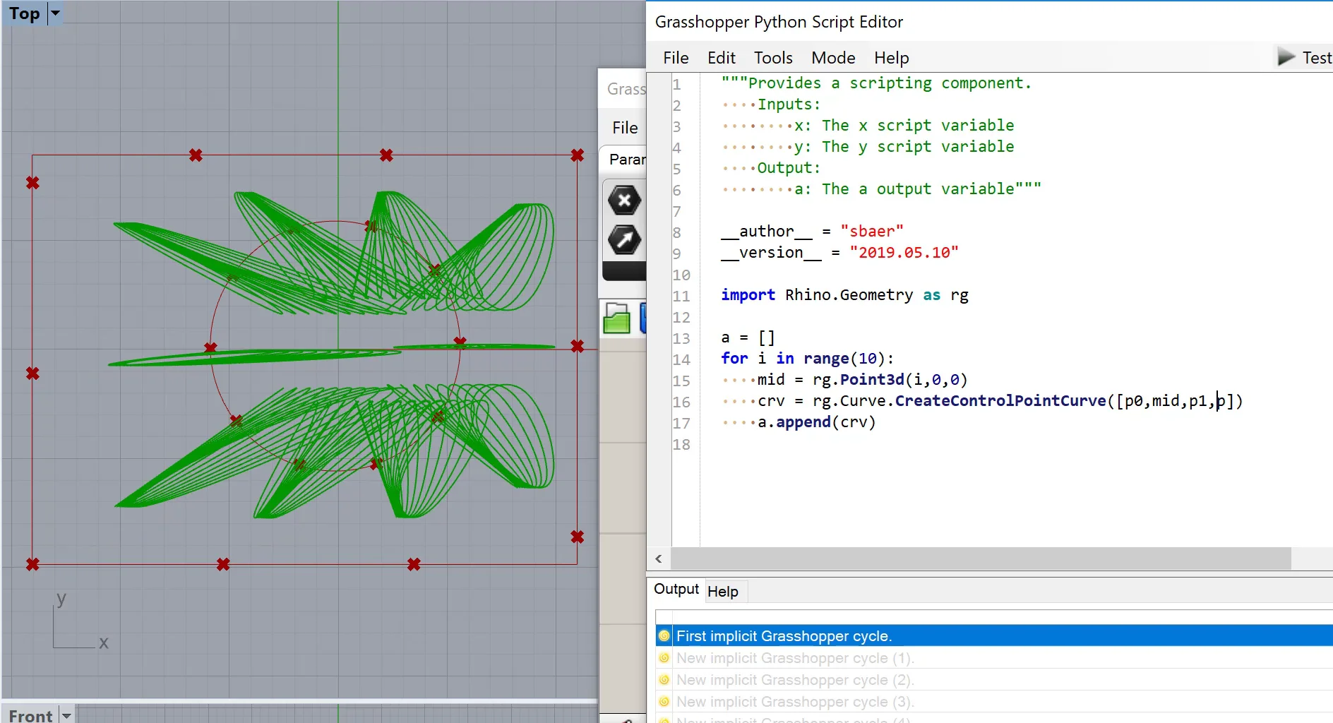

I got pretty far on this feature in V7, but still need to do quite a bit of work to solve the case of not completely locking up Rhino when you accidentally create an infinite loop while typing.
Works for me. I’m not currently testing on a Mac though
