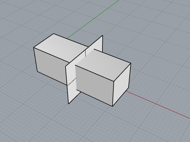

When I use BooleanIntersection with a solid object as the first set of polysurfaces and a bisecting surface as the second set (see pictures below) I get one portion of the solid, as though the solid had been split with BooleanSplit and the other portion removed.
Before BooleanIntersection:
Split%20Part%201
After BooleanIntersection:
Split%20Part%202
Based on the definition of BooleanIntersection, what makes the “surviving” part of the solid the “shared” area and the part of the solid that was removed the “unshared” area? In other words, why did one part of the solid survive while the other part didn’t? Before invoking BooleanIntersection, both parts had the same “relationship” with the cutting surface.
Because my use of BooleanIntersection or SplitBrep (or however I end up slicing and dicing the pieces / parts) will be in a script, I need BooleanIntersection to behave predictably and currently I don’t understand how it chooses which split part survives and which doesn’t.
Hi - for the closed object things are clear as the normals are pointing outward. For the plane, you will have to check which way the normals point. In your picture, the normals of the plane were pointing in the positive direction of the X-axis. The shared part of the box is on the “inside” of the plane, i.e. in the negative direction of the X-axis.
@wim Indeed. Rotating the plane 180 degrees about the Z axis confirms this; the other half now “survives.” So how does BooleanSplit work when the cutting object is a surface (something other than an object with all normals pointing in)? @chuck stated that "BooleanSplit of A by B just does BooleanIntersection of A and B, and BooleanDifference A-B." According to that description, BooleanSplit would always leave part of A missing (when the cutting object is a surface), but in reality, it does not (i.e. it leaves TWO surviving pieces that can be “unioned” back into the original piece).
Intersection leaves one part, difference leaves the other. You can see this by making copies of your inputs. Do intersection on one copy, and difference on the other.
