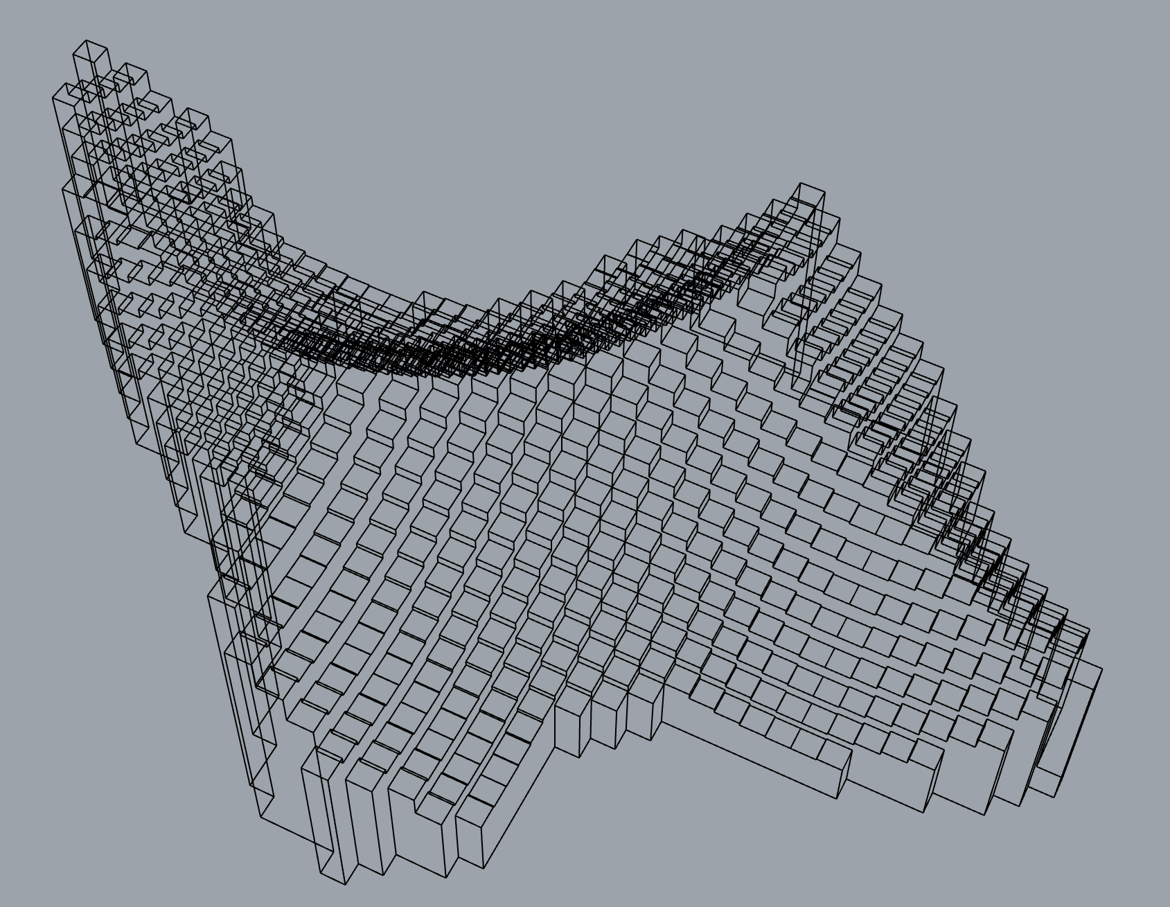

Hello i hope someone can help me i have generated this structure using isotrim and attractor points in grasshopper and baked it into rhino and want to BU all extruded Cubes into One Hollow strucutre
i asked a friend who uses rhino 5 and for him it worked normally by selecting all closed polysurfaces -> MeshtoNurb->BU
however there are a lot of non manifold edges is there any way to get rid of them and convert the structure to a solid by its outer shapes?
My thought is least trying CreateSolid on the right hand object – I don’t know if it would do the right thing but it might.
u misunderstand me i have the left object and want the right. i have similiar structures and i would like to unify them aswell
Ah, ok - I thought you got most of the way there but it had non-manifolds to get rid of. Is the original input polysurfaces or a mesh?
the original input are a bunch of individual closed polysurfaces
Why don’t you post a file? Or a part of it? It will be easier for someone to help you
Note if you have structures like cubes meeting edge to edge as in the image below, there will always be non-manifold edges - that is just the topology, you cannot eliminate them.
structure.rar (5.0 MB)
thing is i want to do boolean operations with this structure and as it is with its non-manifold edges i cant work with it anymore; every boolean operation fails and/or freezes rhino.
whats wondering me is that a friend of mine could generate the correct structure i want in Rhino 5 (somehow it deleted the inside of the structure and just kept the outer planes (which is what i want to achieve too)

Ah, those are meshes. The one from your friend is a polysurface. Don’t expect meshes to work well in this case. You might be able to convert the meshes to NURBS using MeshToNurb, then union them (do it in small groups), it may or may not succeed, it will take awhile…
yes he was able to select all MeshtoNurb and then BU, in my case i get a boolean union failed and the error with the non manifold edges
The meshes are good. You can use their boundaries, 6 per mesh, to build surfaces and join these into closed breps.
I scaled the boxes on this example by factor 1.001 in X and Y. This way you get tiny intersections where you would end up with non manifold edges. Solid union takes a moment but it works.

this way i got the polysurface i want, still i cant create this pixelated roof like structure with booleandifference , now the boolean difference fails
cant really sketch it out…
sth similiar to what you posted
i want to boolean difference B(selected) out of a
b is just a copy of a moved a bit in -z
i need the cubes as solids with a thickness again hence the boolean difference i tried
The bottom and most of the Vertical faces of both A and B are in the same places. Boolean difference will not work when faces are flush like that. Make B wider so that is significantly extends beyond the volume of A you want to remove.
