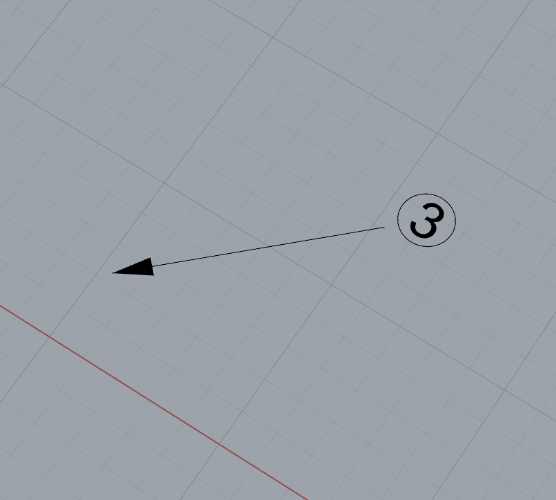

Hey All,
Tabl_ is open source, feel free to help out or create your own branch! There is also a newer version available in Rhino 7 through the Package Manager…
Also, the “Comments” is written and read from the User Text of an object with the key “Tabl_”.

@Gijs is there anyway to get your bubble callouts to be tags of material data ? say I have a marble top and instead of the bubble callout being a number corresponding to the table.. it is now a tag or code that can also refer to a table. For example, a plywood box table with a marble top. I can assign material marble with tag “MAR” to the top polysurface and the box as plywood with tag “PLY”— then when I pull out the bubble it will read MAR and PLY instead of numbers.. and I can customize these bubbles…
@zale_orcid In Rhino 9 Steve added callout shapes that you could use for that, using Capsule style leaders and attribute user text
Thanks! is this in the wip?
the capsule style for leaders is new in Rhino 9 WIP yes.
see also Rhino 9 Feature: More Callout/Mask Shapes
Thank you!
ah, you’re right, my bad. Just more styles were added for Rhino 9
