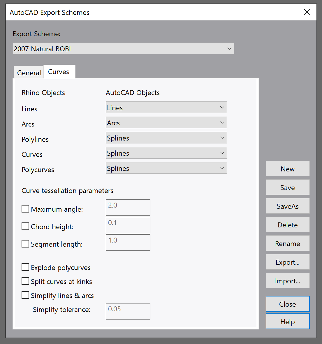

You may also try the following settings while you export the curves to PDF, AudoCAD or any other program:. Rhino’s default settings result into destroying the original shape of the arcs by converting them into multi-segmented polylines… Simply click on “Edit schemes” and repeat those settings. They work flawlessly when I export my curves to any CAD program for laser cutting, printing or engraving.

I used exporting to DWG in my example, but the same settings apply to any other file format that supports curves.

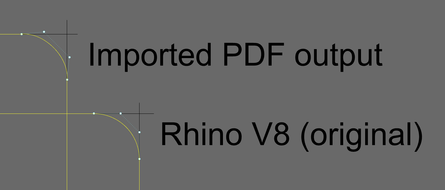

I’ve just saved out a few rectangles with radiused corners from V8 using Rhino’s pdf exporter, and it looks as though this problem is back. When I open the pdf in Affinity Designer, there is a clear ‘kink’ at the join of the straight and the curved corner. The ends are coincident, but not tangent.
Hi Matt - it accuracy to pdf will depend on the scale - you can export the same curve and get very different results.
Original on the right-
So, the details matter - can you pozst a file that shows the problem, along with a screen shot of the print settings?

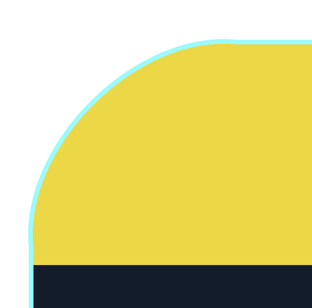

It looks as though the ugly corner arcs on export to PDF out of V8 has resurfaced. This is the result of saving out a 4mm corner fillet as the basis of an artwork file, to bring into Affinity Designer. Acrobat Reader sees it like this:
The cyan lines are used as cutter paths on a vinyl plotter, so this matters when trying to fit pieces one-inside-the-other or with straight edges touching. 90 degree corner fillets seem to be the worst offenders. They all do the same thing. Tangency is lost.
