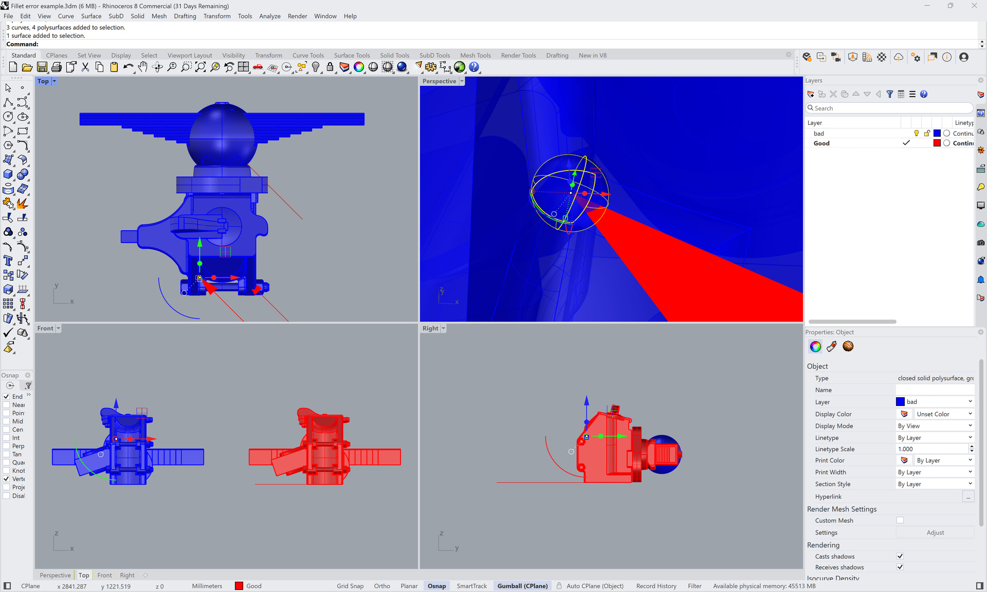

After 30 years using AutoCAD I’ve switched to Rhino, but I have a large library of AutoCAD models to use. Generally Rhino opens the ACAD models without any significant issues (It’s great actually, and I’m not complaining). There’s one consistent problem that varies between minor to annoying though, and it’s one present in many of my models.
ACAD fillets between three orthogonal edges generally convert incorrectly at the corner. Where fillet radii are common, instead of a smooth internal surface there is a sphere. Where the radii differ there’s a torus. There’s occasionally similar errors for reasons I’m less certain of. These surfaces are connected, so they need to be searched for manually.
The attached file shows all of these behaviours. The blue is the converted object, the red is manually repaired. Instances of the common fillet issue are indicated by the arrows. The large blue sphere is one of the similar problems, though not arising from 3 orthogonal edges. Not highlighted, but there are some small torus shaped artifacts in the socket where the leaf spring locates as well.
This is not hard to fix in most cases, the larger problem can be having to search the model to find the instances.

This is a very common Rhino import error.
What’s happening is the trimming of the sphere or torus is backwards. What I mean by that is the part that is supposed to be trimmed away is what remains and the part that remains is what should be trimmed away.
You can fix the improperly trimmed spheres in your file by extracting the sphere and untrimming it and the trim it again correctly using the 3 edges of the hole as cutting objects.
You can also fix the hole by using the script found here. To fix the hole extract and delete the defective spheres and then with the script first set the radius (.1mm) and then click on any two of the 3 fillets that surround the hole.
Also there is a command in Rhino called SphereTangentToThreeSurfaces that can make the trimmed sphere in those corners. To use that one you have to pick the 3 planar surfaces aroound the hole to get it to make a trimmed sphere.

Saving SAT from AutoCAD and importing into SolidWorks produces solids. Saving STEP and SLDPRT from SolidWorks and importing into Rhino produces closed polysurfaces without any fillet problems.
