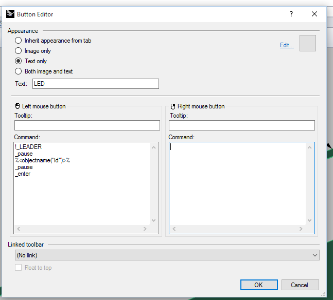

im trying to automate the creation of a leader so it automatically populates the object name of a selected object using a simple marco but cant figure it out.
this is what I have so far but its not working. any help greatly appreciated.

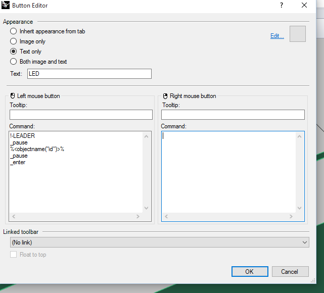

it would be easy to do in a simple macro button im sure. I just cant work out what I need to put in the button.
I have the following but its not working.
