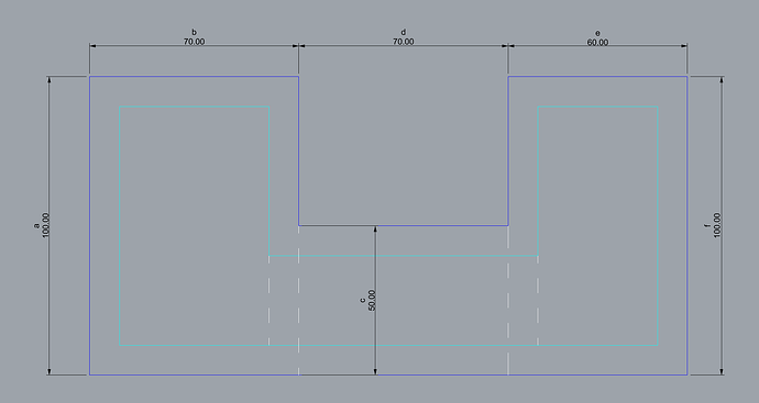

You can try following equation for U shape, solve for x
4x^2-2Kx-dS=0
x=(-b-sqrt(b^2-4
ac)/(2a)
x - offset
K - constant = a+b+d-c+e+f
dS - difference between original (So) and new surface (Sn)
Example - see the picture
a=100u
b=70u
c=50u
d=70u
e=60u
f=100u
So=16500 sq.u
Sn=9900 sq.u
K=100+70+70-50+60+100=350
dS=So-Sn=6600
4x^2-2Kx+ds=0
4
x^2-2350x+6600=0 => x^2-175*x+1650=0
solving for x (the 2nd root x=155u has not physical meaning):
x=10u
So the offset is 10 u
Similir to this you can derive necessary formulas. Also almost (maybe all?) irregular shapes can be converted to the regular shapes.

It works for rectangles:
but when the shape becomes non-rectangular then significant errors creep in. And that’s not even considering cases where the offset begins to self-intersect.
2.5 units squared away from the desired area…
It’s a pretty good way to compute the initial offset attempt, but you just can’t get away from an iterative approach.
@DavidRutten 90% of the buildings on this earth have rectangular footprint or footprint composed of several rectangles.
How does it work for circle and ellipse?
Circle’s way off.
I can add an ‘Offset To Area’ component for curves, but it may yield very unreliable results given how finicky the offset algorithm is sometimes.
