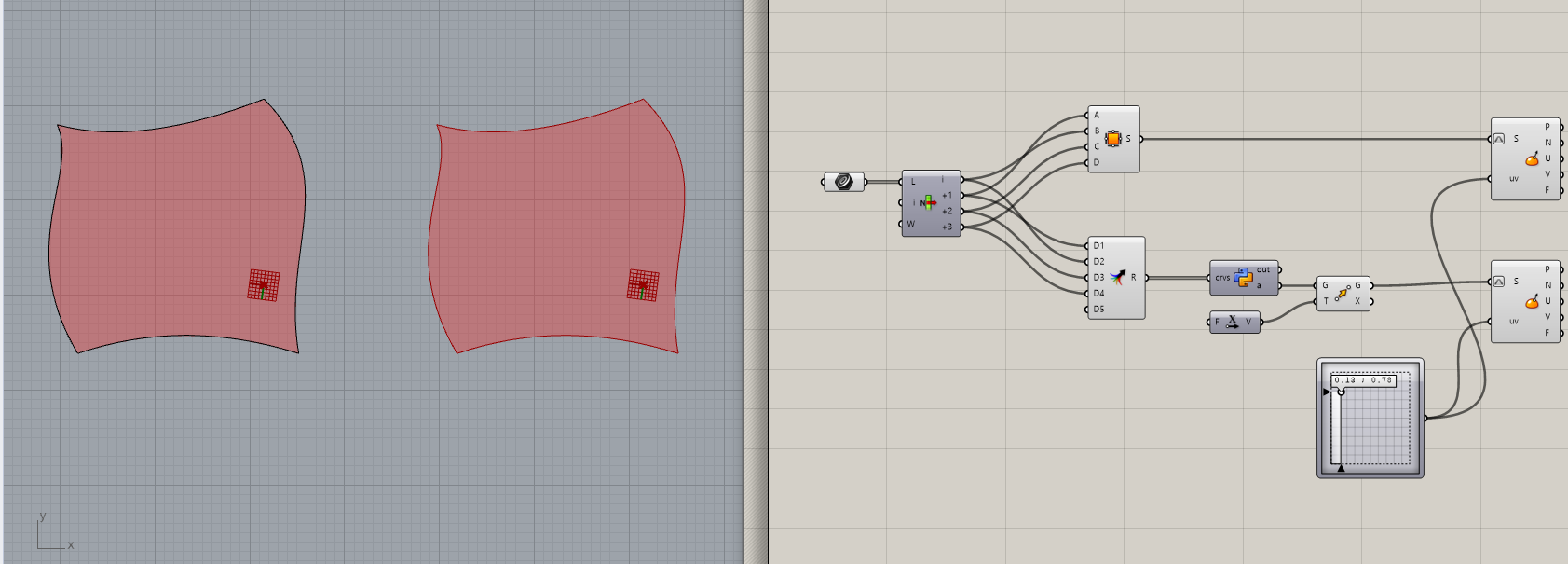

I tried before my first reply, when words aren’t enough, let’s use pictures:
Curve order do matter, and in-between List Item and Edge Surface you have a nice place where to fix the order (in a very simple way!) or to flip some curve, to fix UV topology.

In Ruled Surface, flipping the curve do matter. It’s actually useful, isn’t it?

Exactly , why you switch between A and B without doing the same for the script?
