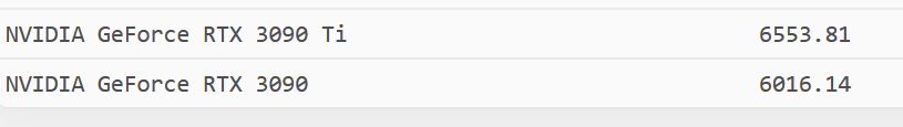

I think in real world usage, you’ll not notice the performance difference all that much between the 4070 ti and the 3090, but you WILL notice all the extra RAM of the 3090/3090TI. @AlanMattano and I have been doing a big render stage and texturing project, and I can tell you the 24 gigs is MUCH needed. when you really get into it.

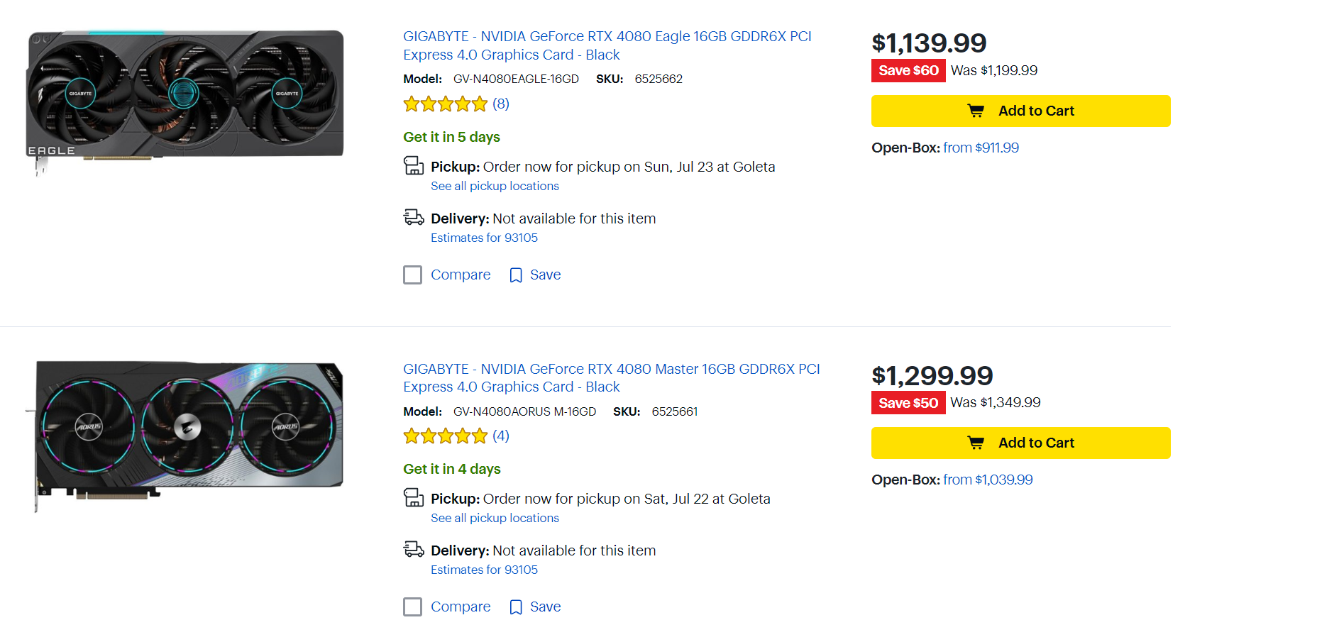

I’m building a machine for my friend’s son - I managed to snag a returned 4080 from Best Buy at $1,000 - came with a full warranty, wasn’t even opened as best as I can tell, because the power cord was still sealed. It’s worth keeping an eye on BB regularly. For instance, this shows up for me right now:
This is the card we got - another open box on this one too:
Open box, $959 is pretty good! Of course you need to be close-ish to a Best Buy - they won’t ship cards to your home, and the returned unit has to be in your general area - close enough that they’ll send it to your local store for pickup.
Heck it’s raining returned cards at BB:
$911.99!

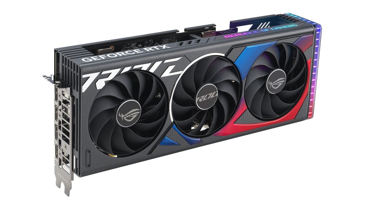

The only card (and I think the thinnest other than a China-only MSI 4090 blower) I could think of was the MSI Ventus 3X, which had no RGB, and offered some space between for air flow if you had two of them. Not even sure if you can still get them.

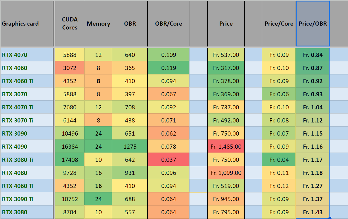

I did a similar comparison for our tiny render farm using Octane Render, which we had a while ago.
[EDIT: I am updating the image with less information and newer prices. Also split the 4060ti into models with 8 and 16 GB since there is a big price difference at the moment)
That’s what it looks like. You basically compare OBR (Octane Bench Result) with Price, to see how you can maximise your investment. The most important factor is Price/OBR. You can see that the RTX 4060 is quite good, but has a low total OBR. You would need 4 of them to match the top performer the 4090. 4x4060 actually costs less than the 4090, but of course its more complex and brings with it other costs (bigger PSU, bigger mainboard, etc).
Usually the 70 series (so 3070, 4070, etc.) is the best balance of power and price in my opinion. You only need 2 to match the top performer and its still cheaper. You can start with 1 and add another later when the price has come down more.
Nowadays actually Memory has quickly become a really important factor. Nvidia is only now realizing this and releasing a 4060 with 16GB. Unfortunately that is why a lot of the older GPUs are not worth considering any more, even though they are often still plenty powerful.
The columns on the right especially are for checking whether it is more sensible to have multiple GPUs and how much the price of for example a used GPU can be to be ā€œcompetitiveā€.
The prices are in Franc and are just the prices I can find currently. I have not updated the older models recently. I also only use the gaming GPUs and not the professional A series ones.
