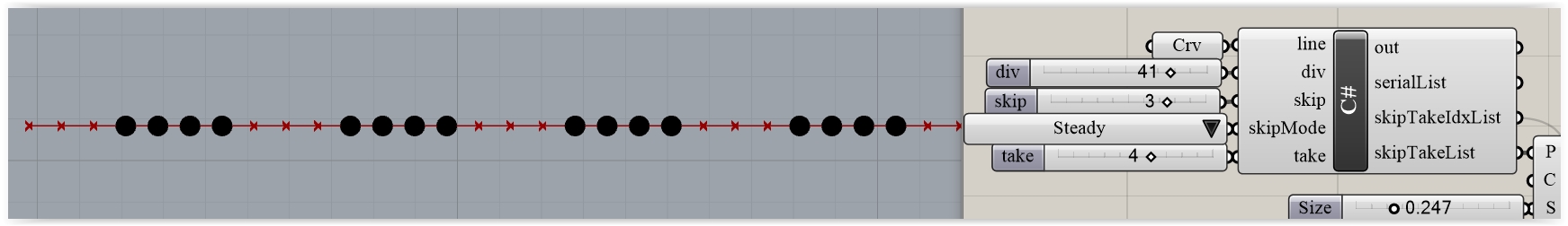

Changed the terminology (and added skip/take in U/V). So … get the gist of the forthcoming V1B using this naive demo.
Plus … a few lines more are required: you want the “U/V gaps/voids” (controlled by skipU/V) to have different values?
So … if, say, skipV = 0 (for simplicity) AND skipU = 3 the gap values are 1,2,3,2,1,1,2,3,2… blah blah. Meaning that the skipU/V are Lists.
BrepFace_GridPts_SkipTakeExplain…gh (20.5 KB)

Hi Peter, The skip/take looks promising.
Would you share please the anticipated V1B? If possible to go back to divide lines by given distance you made in the previous version…
Cheers.
BrepFace_GridPts_V1B.gh (143.3 KB)
