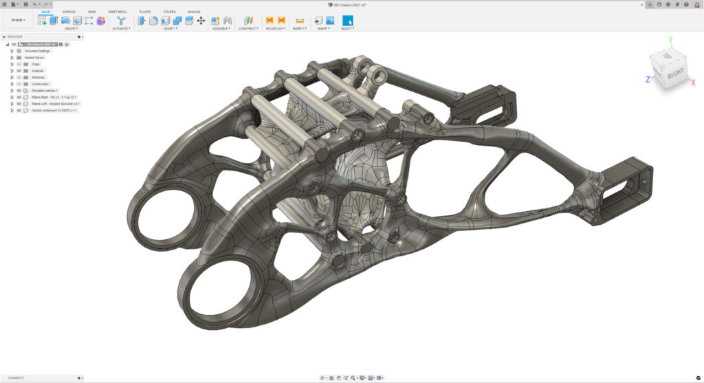

I’ve been exploring various apps related to structural design, but haven’t found anything quite like the AI Generative Design feature in Fusion 360.
Generative Design Fusion 360
As an architect, my engineering skills are primarily focused within my field, but I’ve always had an interest in product design. Specifically, I’m curious if generative design is available as a plugin in Rhino/Grasshopper. Can anyone point me in the right direction?
What I’m attempting to do is create a simple shelf holder and apply some point loads to simulate whether my 3D print will be capable of holding weight. Any guidance or suggestions would be greatly appreciated.
