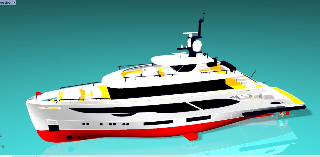

what do the fins do? do they create lift and thus less drag?
These are active stabilizers to reduce the natural roll of the vessel, hence the additional comfort. As an alternative, a gyro could be used, but obviously each have it’s pros and cons
