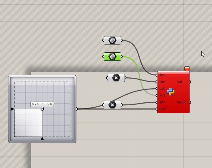

hi i need the gh file this python code please help me
filletsurface.gh (7.6 KB)
