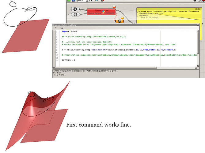

I’m still having the exact same problem djordje points out with the long form of CreatePatch requiring an IEnumerable, but I don’t see the code listed here to fix it specifically for using curves. The command takes a wide variety of geometry as input so I can’t use a little one line loop to force everything in to a points container ( points = [Rhino.Geometry.Point(pt) for pt in points] ). Is there another Rhinocommon container that will hold generic geometry? I tried various things and they wouldn’t work at all.
menno says “You create a Python list here” but don’t I already have a Python list given that I’m just inputting curves into it from Grasshopper?
And what on Earth does “But you need a .NET List{GeometryBase} (which implements IEnumerable{GeometryBase})” mean in terms of what buttons do I push to make it work?
