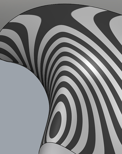

Hello, when using the Blend Surface tool sometimes there is a problem with the analysis of Zebra when I add a new form. It when the new form strongly changes an initial surface… What in such cases to do?

I can’t tell if you’re seeing tangent matching at the surface edges, or a coarse analysis mesh.
Does the image change if you crank up the mesh to make it more dense?
No, the problem of a surface can be seen even without zebra.

I think what you’re seeing is a combination of a loose analysis mesh, and non-uniform isocurve distribution.

You do not indicate where you are adding the shape. Here, with no shapes added and a decently accurate analysis mesh, the blend looks pretty good. Without more details it’s hard to diagnose…

Additional forms spoil smoothness of a surface in difficult transitions… Sometimes it is very necessary to add an additional form for editing a surface, but such piece turns out - and what to do?
Here the difficult grid, any additional forms lead to problems.

I have no idea why you’re modeling these forms this way. There’s no need to do this with trimmed surfaces. You’ve also created surface conditions that make it impossible to create smooth pleasing forms.
Ok, means it is necessary to model so that Blend Surface could create then the correct surface quietly.
All thanks!
Looking at your highlights, you can see that you already started wrong.
Usually you start modelling with parts with less curvature involved. You can call these surfaces “base”-surfaces. If you don’t ensure they are perfectly smooth, you can never expect other parts of your model to be cleaner than them. There are dozens of strategies for clean modelling, but personally I start with 3x3 single-span surfaces (degree = cpcount -1 = Bezier), increasing degree up if needed, Making them join up g0. Such surfaces are perfectly smooth, since they are parabolic, or if of higher degree, they are at least controllable.
Parts representing higher curvature are blended in between your base-surfaces. Now the difficulty is to layout surfaces in a way that a shape can be represented with that. But this is practice only, so try again… :slight_smile:
