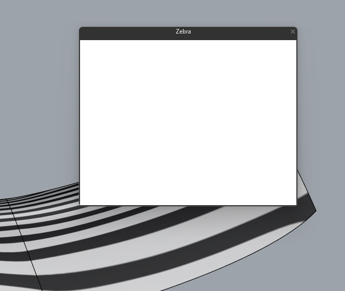

Zebra dialog box not showing details
Has this been made aware of in the latest WIP. At least on my computer. Thank you,Mark
Thanks for your reporting, pls run the SystemInfo in the command line of Rhino, and past all popup contents here. Thanks.

Thanks for your sharing. Please run the PluginManager in the command line of Rhino, then uncheck the following plugins, and restart Rhino to see if it works,
  • VRayForRhino.rhp
  • CS_ModelingPlugIn.rhp
  • Xirus.rhp
We know about this bug and are working on a fix. The dialog will show its controls if you dock it.
