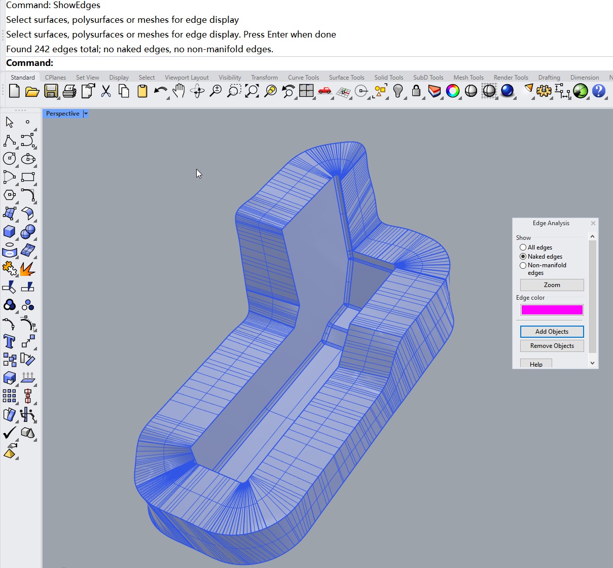

  • SolidFillet on a polysurface constantly breaks edges based on what I see in “showedges” I have to constantly mess with the order of how I fillet the solid. i.e. do these 4 first, then these 2, then this one and in that specific order, or the solid folds over and breaks. It’s a constant game and a waste of time, until I get the part to close (leaving just the opening on the bottom).

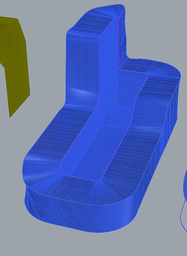

  • After making a surface of a part, I need to do two things. Offset the part by 1mm to create a test file, and then offset the original part 2mm, taking the outer “shell” to make the mold. If I try to "add thickness by using offsetsrf and creating a closed solid, the part breaks and I’m left with more holes in the outside of the part. Are you saying that I need to remake the part twice at different sizes and then connect the two? This is what I’m seeing on the forms. Are you kidding me? What’s the point of offset surface, when you can’t offset a surface? The only way I’ve been able to get around this is to convert the polysurface to a mesh and then either extrudmesh or offsetmesh to get mesh to get thickness or offset I need. Photo below is result of a offsetsrf.

Issue 1: Fillet
  • Whenever I try to fillet a part, it always results in edge gaps as shown in the photo above (using show edges command). This creates a lot of issues when I continue to work with the part. Since this post, I’ve switched over to using, blend edge, which seems to work better, though I still have some issues..
  • If you take a look at my file, it’s the 1st tan colored part that I’m trying to fillet. I was able to get this to work successfully as shown in the middle tan colored part, but that was only after trying 20-30 iterations of, running the command and changing which edges to fillet first, then restarting the command with the 2nd set of edges, then restarting again for the 3rd set of edges, etc… While the program lets me fillet all of the edges and change fillet sizes upon running the command only 1 time (set size 1 and select edges, then size 2 and select more edges, etc.), doing so results in an open part as seen in the photo from my first post.
Issue 2: Offset/extrude/shell to create wall thickness.
  • The second issue is regarding creating a thickness to the part by using offsetsrf (extrude and shell don’t seem to work right?). I am unable to successfully create a closed solid to work with.
  • As seen in the third photo (blue part) from my original post, there are still issues. The only work around is to convert to a mesh and offset from there. I’m trying to understand why this and I’m trying to stay in polysurface so I can effectively work on the part after performing the ribbonoffset (3rd issue)
  • From what I found on Rhino forums, people were saying that I needed to completely remake the part at the larger size and then combine the two. That’s ridiculous and completely defeats the purpose of extrude or the offset command.
