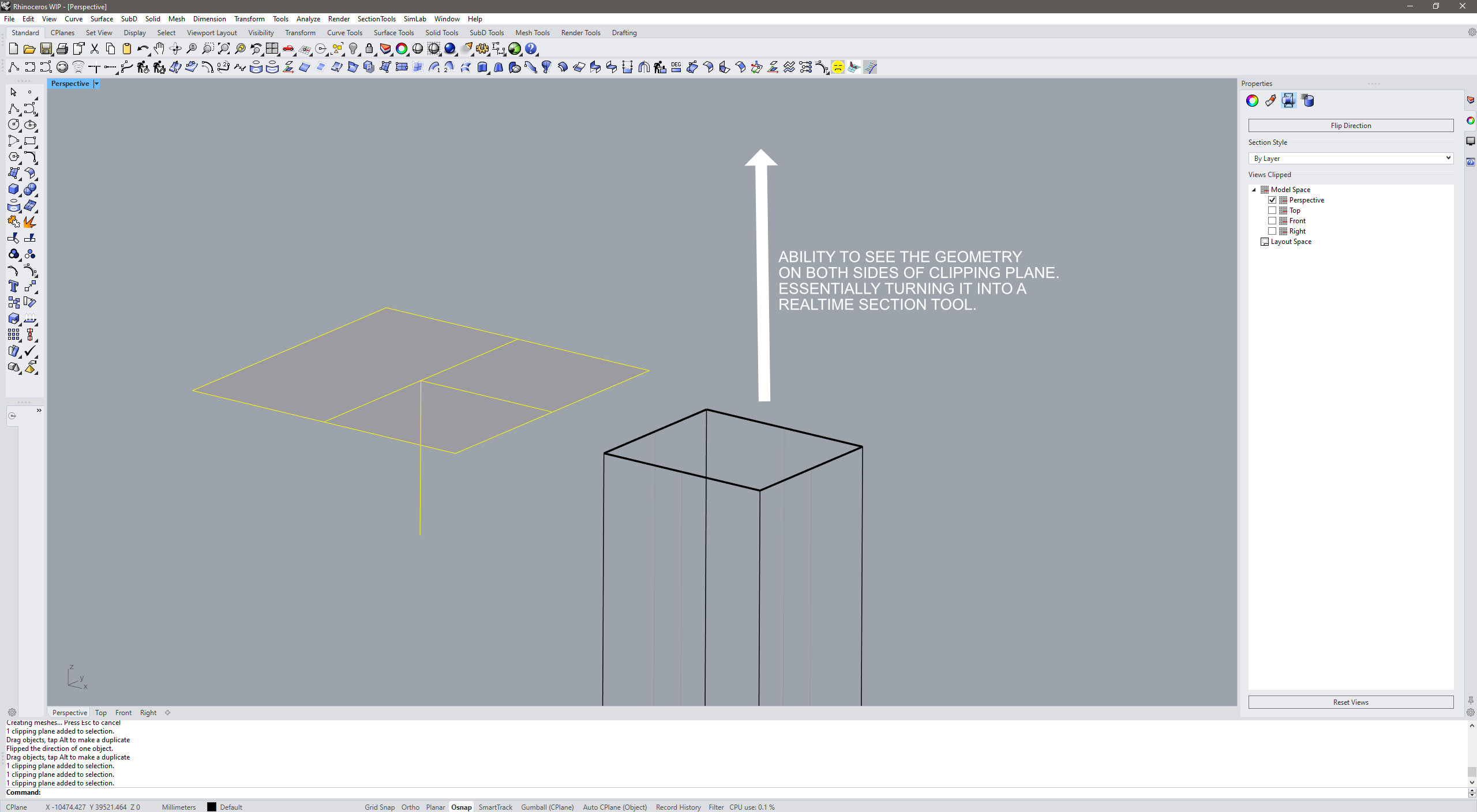

I’d love to have an option with the clipping plane to display all the geometry (so no clipping occurs) so that we’re left with a realtime section tool!
Many thanks in advance!

…and one other wish…
Could the section be selectable geometry so you could measure distances etc?

Just tried Section tools which give me something I can measure from but they lack the realtime ability of the clipping plane unfortunately (they have to be manually updated after geometry change).
Nearly there though!
Not selectable, but the section can be snapped to:
Thanks Gijs, I had another try and you’re correct, I can actually snap to the sections for measurements.
What I did find though, was that the display marker for the ‘Near’ snap doesn’t show (but the text does). I think this must have lead me to believe I couldn’t measure.
Picture of missing marker below-
Yes, I’ve seen this before happening (not only with Near Osnap), but it’s not always failing
I’ve logged RH-72025
