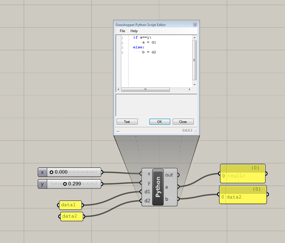

I rarely used Sift just because it feels more easy to me to do it in Python. But because of that, many of my user objects are dependent of the Python component. And that’s what I want to avoid.

#5
Well the difference is that I have two lists as input. The script that you wrote is like in the image I attached.
