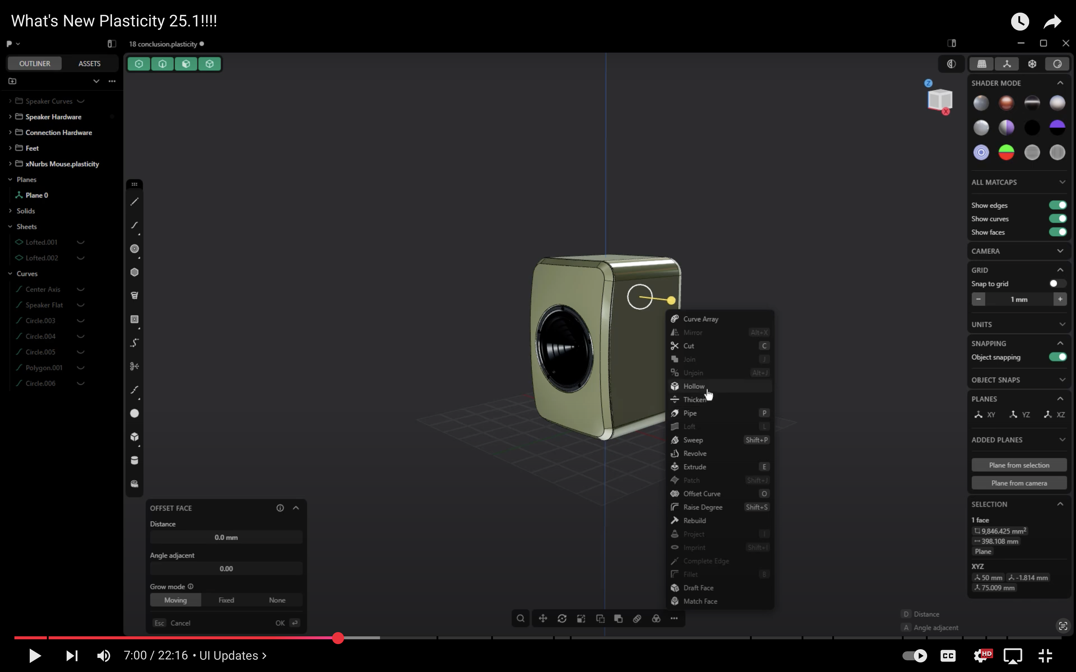

I really would love to see this feature - it would be much more powerful than new icons
this feature is available in plasticity and called “suggested commands”
screenshot
link to video
