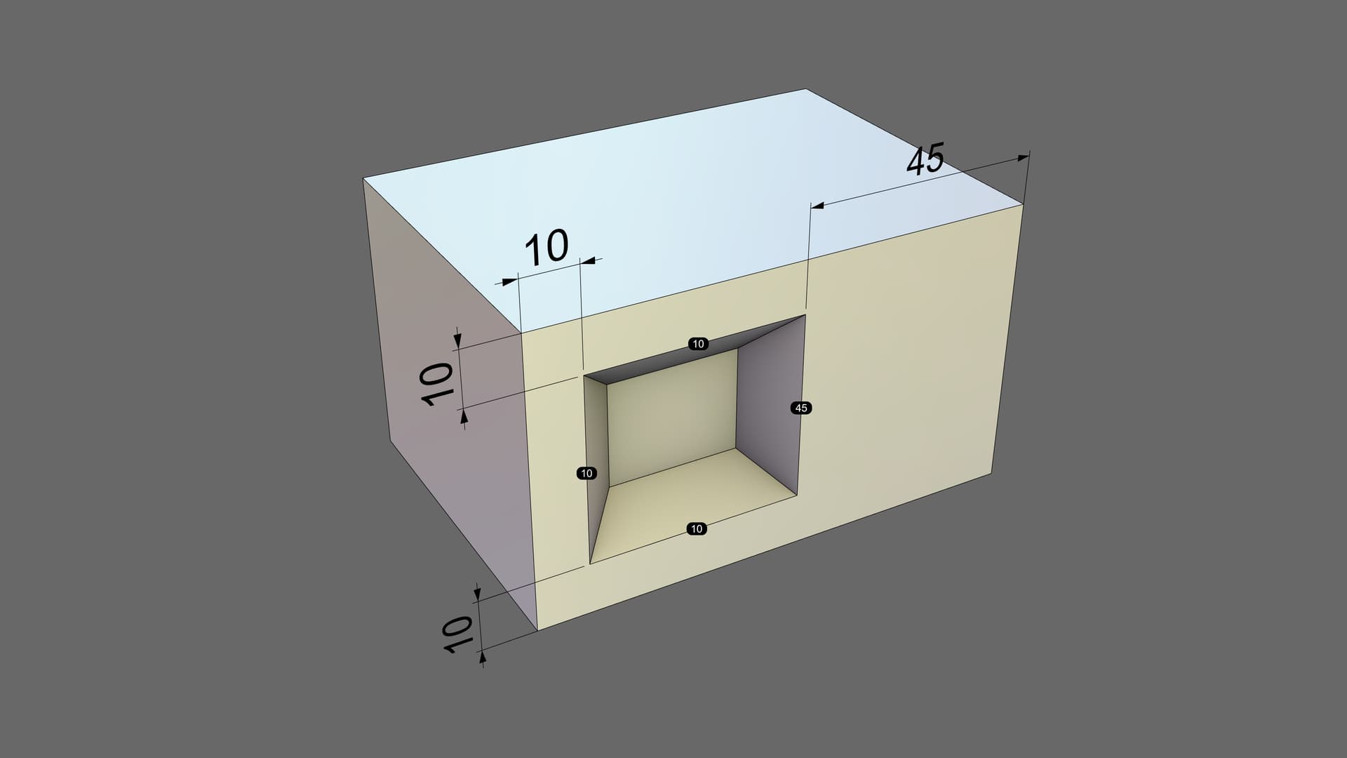

While the “Inset” tool is nice, I think that Rhino will benefit from having a more complete alternative tool (InsetExtrude) that offers both, adjustable individual offset distance to all sides and extrusion of the newly created face. Here is a quick example that shows the ability to set custom offset of the edges and extrusion (negative in this case) simultaneously. Once the command is completed, the extruded face is selected automatically.
Additionally, the dialog box (or Command line options) must provide 3 options to set Bevel, a.k.a. extrusion angle, with 90 degrees being the default value (a straight extrusion) and 45 degrees as an alternative value, since those two are the most commonly used extrusion angles. The 3rd option is a numerical field with tiny vertical arrows where the user could set any custom angle via the keyboard or the aforementioned arrows that change the value by 1.

Is the hoped-for result different from what you’d get if you created an extrusion yourself and booleaned it with the parent solid or is more complicated?
The idea is to be able to accurately place an inset on a face, by adjusting the offset distance of each edge. the example shown above is of a simple box. Obviously, complex objects with multiple edges on the selected face will result into having an inset with the corresponding number of handles to adjust the offset distance.
The “Bevel” option is a convenient way to automate the creation of architectural or futuristic shapes, especially for those who use 45 degrees. Like the sample below featuring an inset of 10 mm on 3 of the sides and 45 mm on the 4th side, 8 mm extrusion distance, plus an optional bevel of 45 degrees.

It seems handy to me and also seems pretty easy to implement using the primitives they give us to work with.
Not saying it wouldn’t be good to have in Rhino, but curious: Some of the CAM plugins must include features like this?
While the example model above is quite easy to make with the existing tools in Rhino, more complex shapes will definitely require a lot of time to achieve such an “InsetExtrude”, especially with added bevel at a certain angle.
