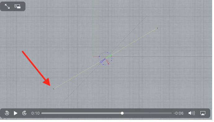

In the video below I’m first keeping the mouse close to the center of rotation. It is difficult to rotate just by a small increment because of the resolution of the mouse. When moving the mouse further away from the center of rotation, it becomes easier to rotate just a tiny bit.
In addition to moving the mouse pointer, you can zoom in and out at the same time as you’re rotating, using the mouse wheel or a SpaceNavigator. It becomes much easier to rotate just small amounts.

The first video shows an attempt to rotate the line by a tiny bit. With the mouse close to the center of rotation, it is difficult.
The second video shows how the rotation snaps and I create a first copy by tapping ALT. Then I rotate again, zoom far in and create a second copy of the line.

I’m not moving the pivot, just the mouse / cursor further away from the center of rotation

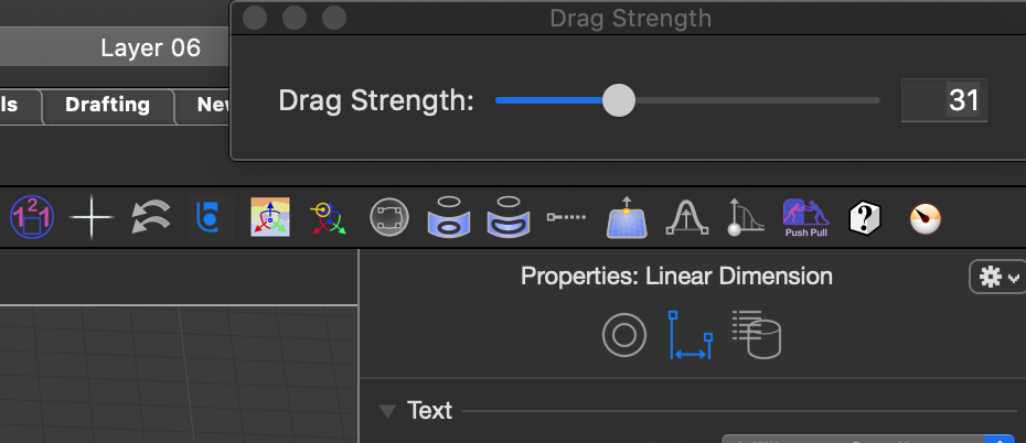

The rotation arcs are also not comfortable enough to control precisely with a Wacom pen, improving the Gumball in this regard will be very welcome.
the drag strength slider on the Mac UI is very large and there is simply no place to park it without obscuring other UI elements…
A little slider that cold fit into one of the mostly empty UI horizontal bars will be very nice, and usable.
